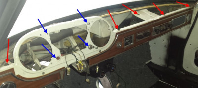

Dear Franco,
I guess there is a misunderstanding about your indication of 1967 Lancia Flavia S2 in the description, the production of Flavia S2 coupe (chassis type 820.030/1 or 430/1) has been started in 1969, I guess that your car is not a 2 liters 820 but a 1.8 litre 815.300 (or 815.430) with circular odometer instead of the horizontal one, the production of this model started in autumn 1965 (MY 1966) and is quite commonly defined as 1800 S2 but is not because the chassis type is the same as the previous version and the chassis numbers continue the previous numbering, then is a simple restiling of the S1 coupé.
Coming back to your question... assuming that your car is a 1800, to dismantle the wooden dash you have to proceed in this way:
- remove the wooden plate from the gauges - this is a quite easy task because if just fixed with by 2 screws and 2 knobs (see blue arrows in the attached picture)
- remove the upper side of the dashboard that is secured in 5 points, see red arrows in the attached picture
At this point both left side and passenger side wooden plates will be accessible from behind, you will have to remove many small nuts as written by Luigi then you will be able to remove the inox (not chromed) surround and the wooden plates.

Thanks Giovanni! This is perfect! The dashboard in my car is exactly like in the photo you posted but with 50+ years of sun and heat damage
. It appears to be a pretty involved task to remove the wood panels. My car has not been easy to work with as half the bolts or screws are frozen due to rust. I will attempt this on the next phase after I am done working under the hood.
