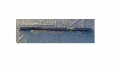

One of the tools for the rear spring was a kind of "spanner" that allowed to keep the spring "stretched" while removing one end or the entire spring. Have made a pair for myself. Is not that hard to make, but it is still some work. See one picture for the orriginal, afraid is not so very clear. Other picture shows the "home-made" version.
You could make a simple temp one by just making a steel plate of the correct length, and use that as a "stretcher" and then release the load on the spring by jacking up the rear till the spring is being "spanned" on its ends by that steel plate. Be very careful, if the spring unloads suddenly, that can result in injury.

Maybe a simple flat steel plate risks to buckle and bend under the load. An angle piece or steel tube (like in the home made version) would be better
