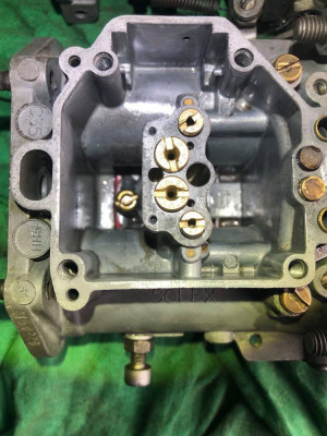

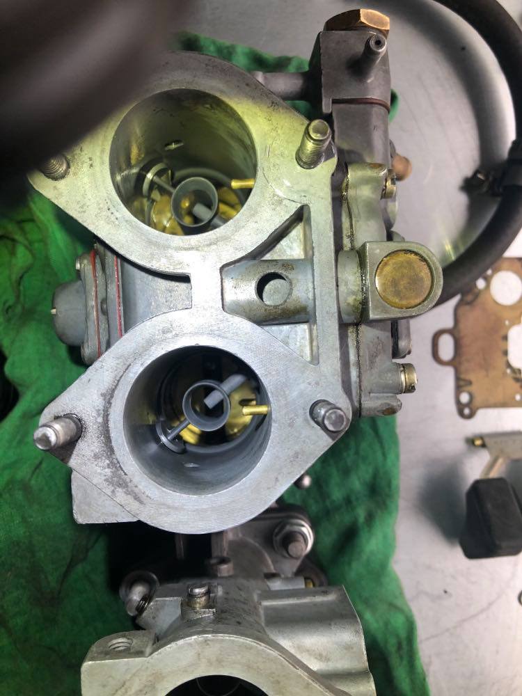

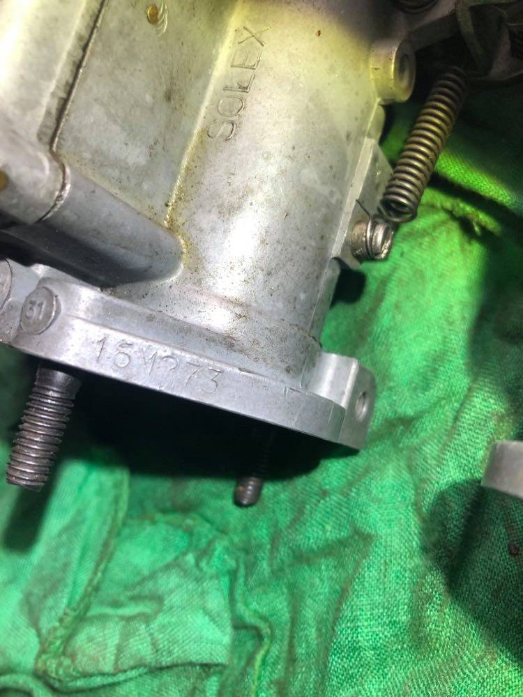

I would need some help with with a Solex Phh C35 (as you can see we miss the version No. stamping).

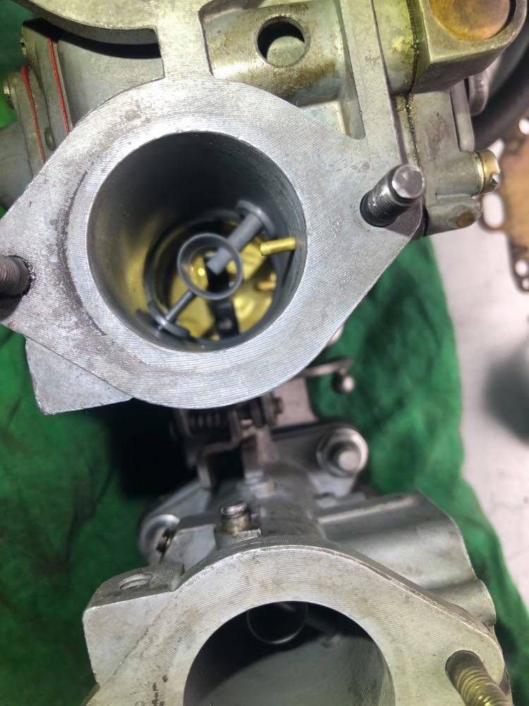

We are new to this carb, and we suspect that is missing its venturi (choke). Could someone help with it?
We are also looking for a Solex Phh C35 workshop manual to get to know the carb better.
Note: The car works well with full throttle, but half throttle and from low rpms, it stalls.
Thank you in advance for the help!
Peter

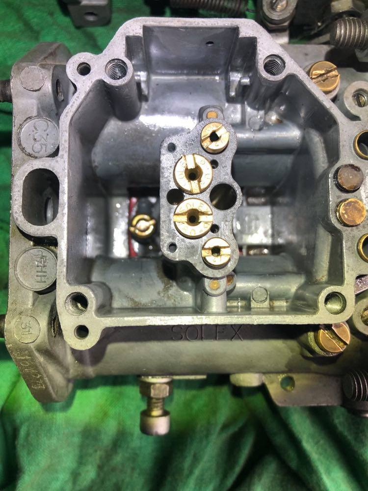

The C.35 PHH carburetors have the choke integrated in the cast, it is not a separate part. If you look closely, you will see that the tube narrows going to the butterflies, and then widens again at the butterflies. On the small roundel is the figure "31", and the is the integrated choke size, 31mm. It is for a 818.303 engine.

The version number IS stamped in, but it is not very clearly visible. These are C.35 PHH 23 (version number 23)

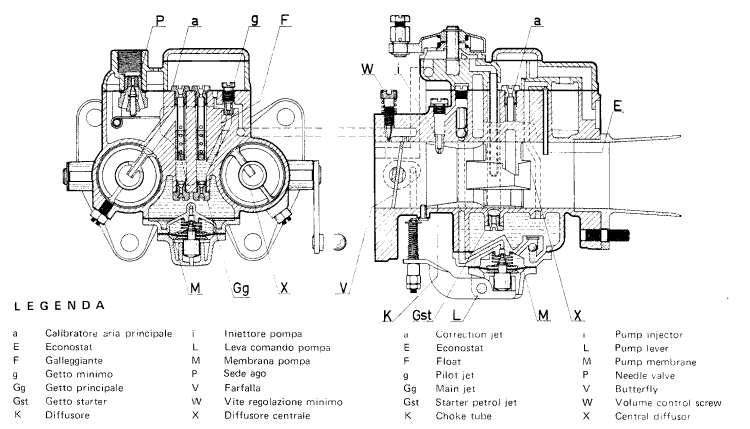

Included pdf is a brief description of the operation, explaining the key parts of the PHH carburettors. It is not much, but at least may help a little bit to understand the most important aspects.

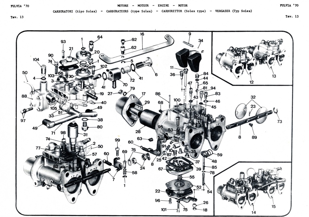

Yes I would have a further question. We have found the Volume Control Screw pretty easy to turn. There was no washers or O-ring used. It also gives a bit of air leak of the carb.
I have checked on the parts catalogue where the Volume Control Screw (95) has some kind of washer (45). Could you please advise me, what kind of washer is to be used to have an adequate sealing.
Thank you in advance, Peter
