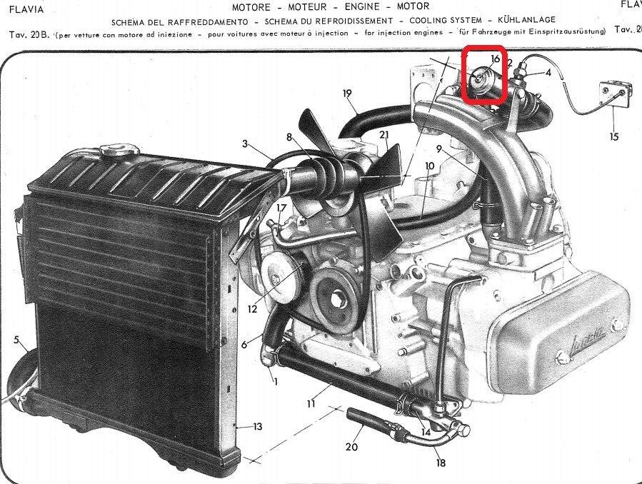

Did you check if the thermostat is working fine ? The problem may occur if the thermostat is not open enough at high temperature.
If you are not sure, remove it (it's quite easy) and complete the coolant liquid. Just for the test. See picture.
If the problem disappears, install a new thermostat.
Notice that the speed (and the volume) of the air crossing the radiator is quite the speed of the car. So on a motorway, the air flow is much more powerfull than in slow traffic.
Pierre.
