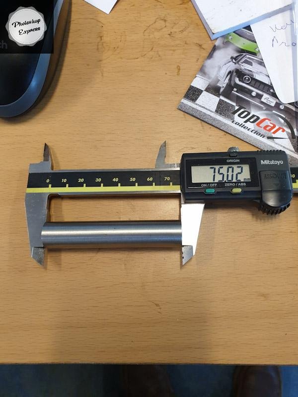

And carefully check the steel M10 bush through the rubbers at the rear of the gearbox. If that one has been shortened I bet 10 to 1 that the subframe mounting boxes in the sills are bad. Or the subframe itself.

Could you please explain what 'shortened' means?
Distorted by pressure/wear or modified by some 'expert' mechanic?
Do you have the correct dimensions available?
Thanks a lot, new rubber parts for the gearbox have arrived and will soon be installed...

See the picture. This M10 bush should be 75 long.
If the subframe outriggers are bad or the subframe mounting boxes in the sills, the body sits too low on the subframe. The gear shift mechanism touches the tunnel. Some shorten this bush and cut part from the rubber supporting the rear of the gearbox.

Perfect, thank you. So it's the 'expert mechanic' problem.
I'm going to watch out when replacing the gear support rubbers.

I'm lucky - 75mm length, however quite corroded.
Anyway it was not possible to remove the upper gearbox rubbers - not enough space available without damaging other parts.
Any hints how to do it with amateur equipment only?
