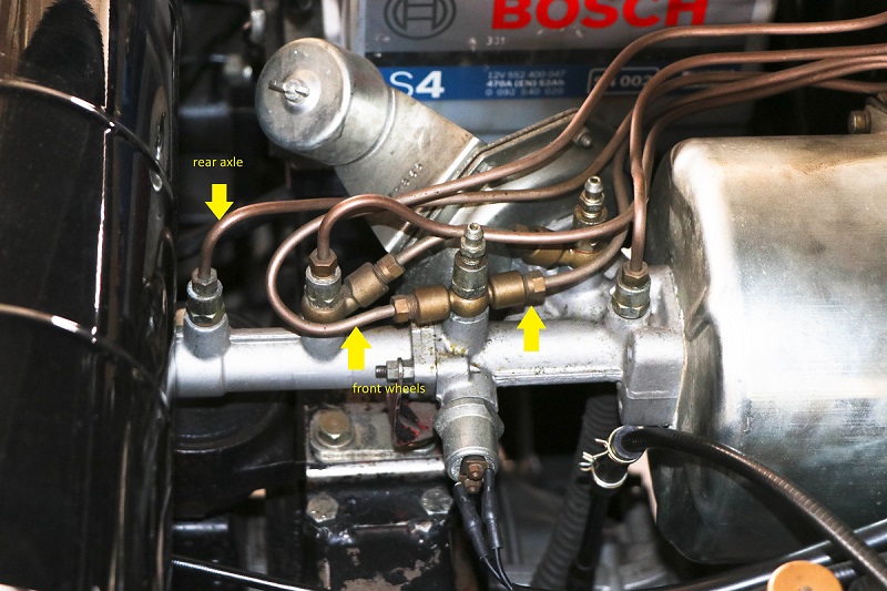

Brian, the rear circuit of the booster is operating the front brakes (it is a Lancia). I bet the air is coming in exacty at the booster rod sealing. Had that several times and am having it at the moment with my Flavia Vignale. No liquid visible in the booster chamber. Bleed the front brakes and booster circuit only, and everything will be fine for the moment. After that, leave her in the garage for two weeks. Then go for a ride, the problem will be there again. Prove me wrong, always willing to learn!
flavia booster.jpg (193.28 KiB) Viewed 2426 times
