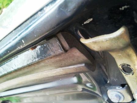

2) rubber gasket just under the front edge of the bonnet, and which,is supposed to rise the bonnet when the lever is pulled from driver place
Please refer to picture attached , that I picked from a car during a Lancia meeting, and compare with the rubber for sale by the same webseller : Engine Compartment Gasket SKU: AC2GZ180

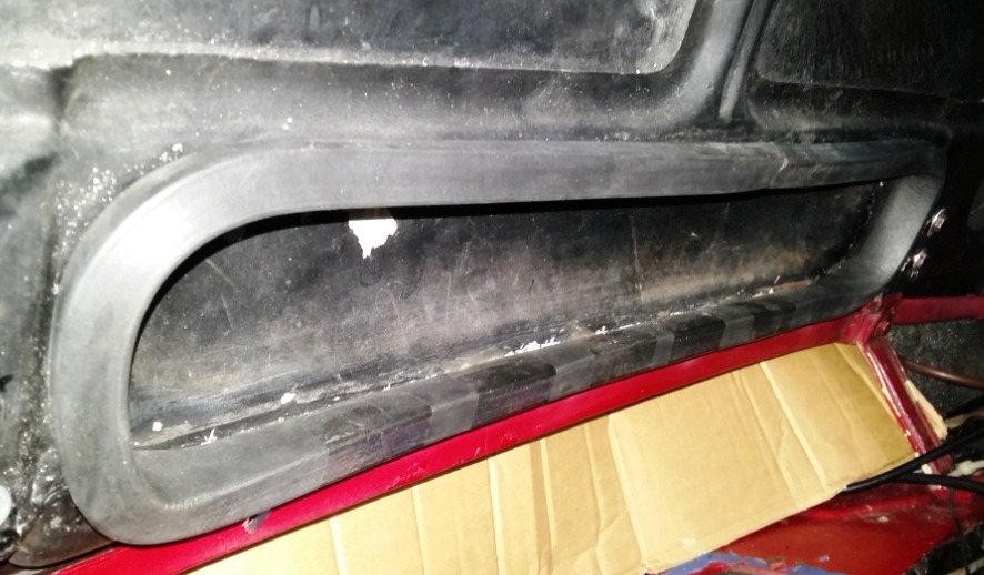

Hi Thomas, thank you for your interest of my question
I think there is no problem with sellers, they all sell the same products. So I have bought the rubbers in last december at Elvezio. I had few time to begin working
One rubber is needed between the air conveyor and the bonnet : it was rather hard to set it in place, the rubber is quite strong and thick and the angles are not exactly perpendicular...but worse, once the bonnet in place, it was impossible to close it because the rubber is too thick ! So I went back to a "home made solution" with another rubber fitted on the edge of the conveyor, and this works quite well.
The second rubber comes in the front edge of the bonnet. I have never seen such a rubber on my car (bought in 1984) so I had only a picture of this rubber that I saw on another car (third picture).

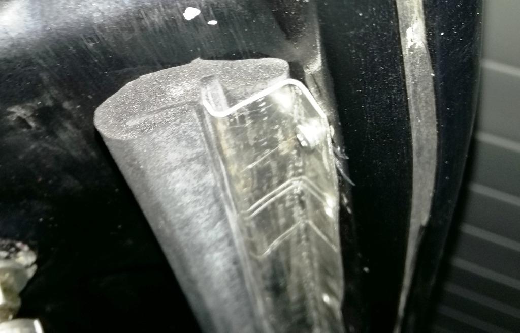

The new rubber that I received is not exactly the same. I had to make by myself a sheet of metal to fit the rubber in place.(may be some glue could work ?) Several tests have been necessary, but at the end, it works, so I am happy with that.
Now my bonnet is correctly fitted once it is closed....and i stop trying to know why the first rubber is too thick and the second quite different !
Thank you for reading, my english is bad, see pictures.
best regards. georges2
