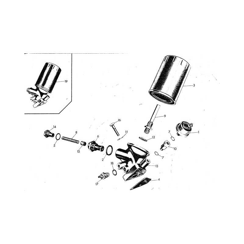

Thanks for you reply Andrea. Just to clarify me, do you mean that I need to change the oil filter base (as nr. 13 of the attached picture), because the one from the HF is different from the S2 1.3? So it is not only a question of adding a sensor?

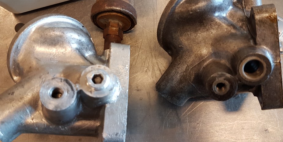

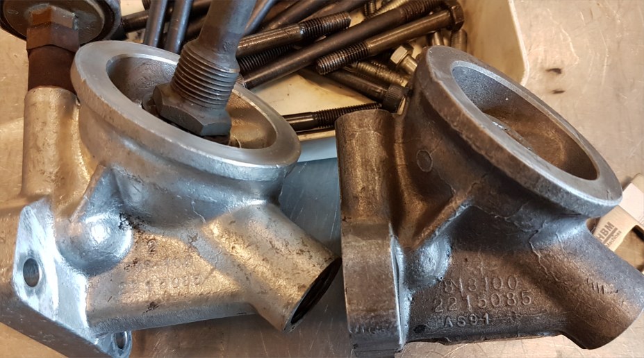

The series 1 HF engines also had an oil cooler and consequently an other oil filter base as the hoses to and from the cooler had to be connected to the oil filter base.
The S2 1600 did not have an oil cooler.
See attached pictures. The one on the right is from an S2 1600. The one on the left is from a 1300 engine. Both units have the same 818.100 casting number. The only difference seems to be the machined diameter and thread of the hole which has the sender in one case and a plug in the other case. Maybe not even that. These are from engines I am rebuilding now. I don't really want to take the plug out and check if it fits in the other unit.

Depends in what sense "different" is used. To me it seems that machining the hole with the plug to accept the sensor will do the job. Or find a sensor that fits the existing hole
Is it then the same filter base with a modified hole or is it a different oil filter base? Both statements are true I suppose.
