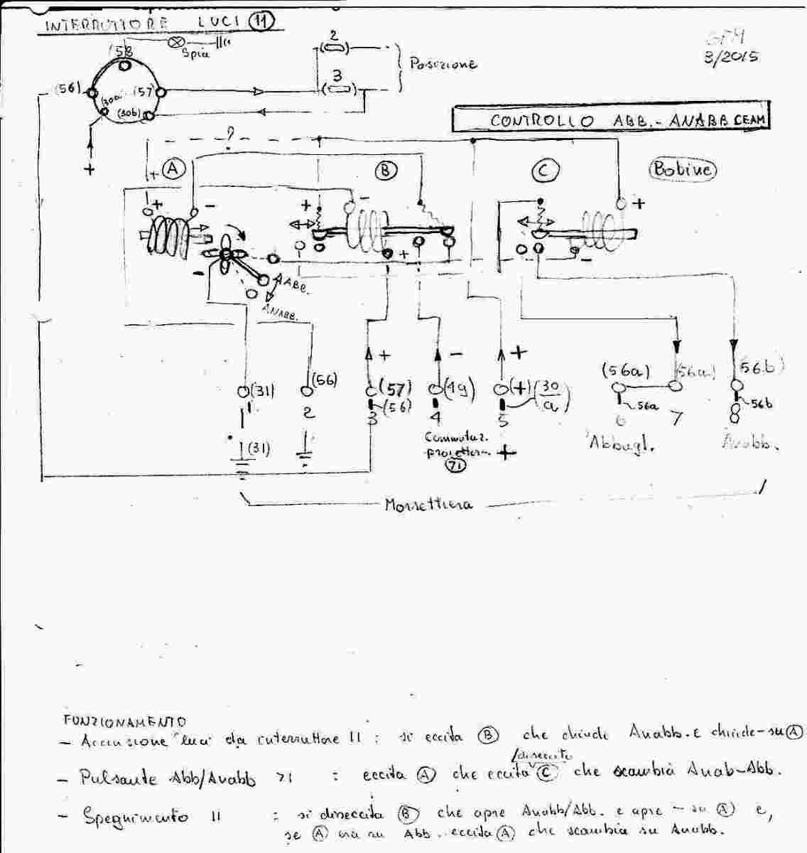

During the overhauling of my GT I enjoed myself in triyng to improve the schematig wiring diagram attached to the car Instruction Book.
After the painstaking work of numbering the various wires and checking the connection now I attache the results.
These are obviously in a compressed form and in italian language.
If someone ask, I can provide the PDF file that when printed in A3 is fully readable and, if needed, some explaniation/translations.

I have the workshop manual and the wiring diagram does not match my vehicle but yours does .
