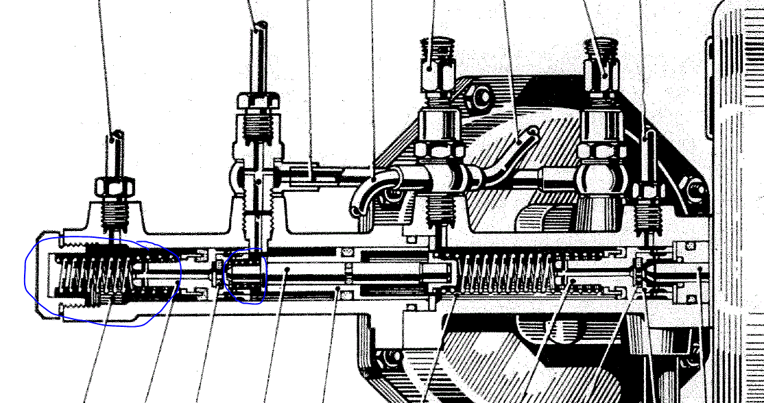

Re: Brake servo cylinder
Miika,
I rebuilt my servo unit about two years ago and in the initial build I had several issues that I had to address to get the system to work properly and one was reversing the same springs. From my memory and taking a look at the attached servo cross section the strong spring is installed in the rear circuit chamber. The rear circuit push rod is held open by a light spring (small blue circle) and when brake pedal pressure is applied to the circuit it overcomes the light spring sealing the rear circuit port valve. So the heavy spring (large blue circle) allows the light spring to bottom out and also reduces the fluid pressure for the rear circuit.
Another issue I had was with the master cylinder check valve springs being too weak so I was not getting a good seal thus not enough fluid pressure going to the servo circuit.
Make sure you have no vacuum leaks particularly around the vacuum end cover gasket or the brakes will tend to stay on after you release the brake pedal. I used a RTV sealant on both sides of the gasket to correct the vacuum leak issue.
Make sure you soak the assembly in a light penetrating oil to avoid corrosion to the aluminum parts.
Once I addressed all the issues the car braking system was as good as todays cars
Brian
Brian

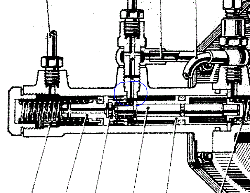

Miika,
Make sure the rear circuit slave cylinder is installed passed the threaded stop (circled in blue). This prevents the strong spring from acting on the small rear rod spring in the static assembled position.
Brian
Brian

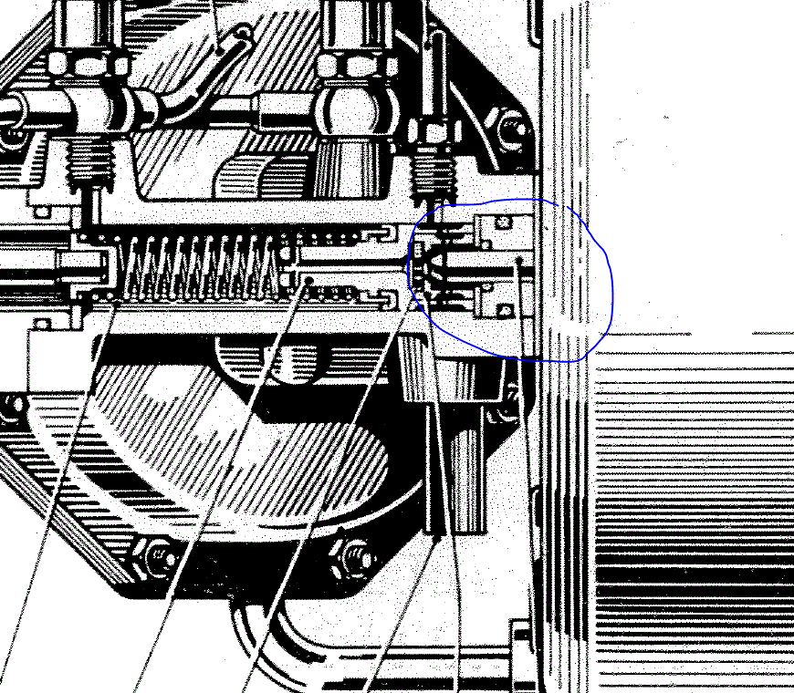

Miika,
When you get a new seal kit make sure the cylinder piston rod seal ID is the correct size for the piston rod before you install into the servo housing. My kit had a seal for a larger piston rod OD and I did not discover the leak until I went thru a lot of brake fluid creating a big mess. You will not be able to detect the leak right away because the brake fluid leaks into the slarge vacuum chamber.
Brian
Brian
