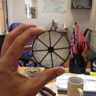

Hello friends! My report on the above-said problemme. It was tested air flow sensor and valve droselnaya - proved 100% working, but I decided pestrahovatsya and took parts from another machine which has no such problem. takoyzhe as the result was nothing izmenilos.postavil back the old parts. He went further to explore. Fuel SIS theme brushed mesh (pictured below) was strongly clogged after cleaning the grid all got worse, now the machine is not just twitches and lost traction, and refuses to go all three temperatures. And for some reason, and the meter to begin work incorrectly. error appeared - a failed ignition tselindrov each time they are different. 12 and the injection time of 20 ms, idle 4ms. I think that the reason gasoline pump - your opinion friends.can tell what should be a time of injection and how to check the fuel pump
thanks.
thanks.
