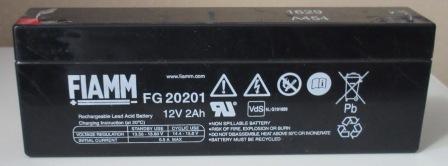

HI,
Sorry to reply you so late.
The battery used for the EPB is FIAMM ref FG 20201
it's a 12 volts / 2 Ah. Available as a LANCIA part but available too in other shops.
You can found similar batteries at other manufacturers than FIAMM.
Best regards,
Pierre

- img_1394.jpg (28.1 KiB) Viewed 19067 times
- img_1393.jpg (26.23 KiB) Viewed 19065 times

FIAMM Battery approx 15Euro, don't buy it from FIAT crooks
