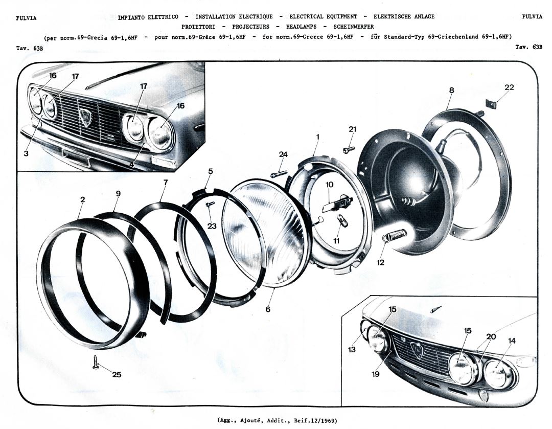

In the CDdocs of S1 & S2 Fulvias, I try to find exploded views, partnumbers and description of parts for the specific 170 mm headlights, unsuccessfully
Is there such a schema somewhere ?
Thank for any info or picture

This is the official tavola
- knipsel2.jpg (147.75 KiB) Viewed 668 times
Re: Fulvia 1600 head lights
Thank you.
the third part starting from right (after 22 and 8) has no number. What do you call that ? (in french we say "cuvelage")
I suppose this part is the same for external and internal lights on the coupé, this means that part N° 1 for the 170 mm beam unit is different as it has to be screwed on the 136mm "cuvelage" and has a larger "front" diameter to receive the 170 mm unit ?
