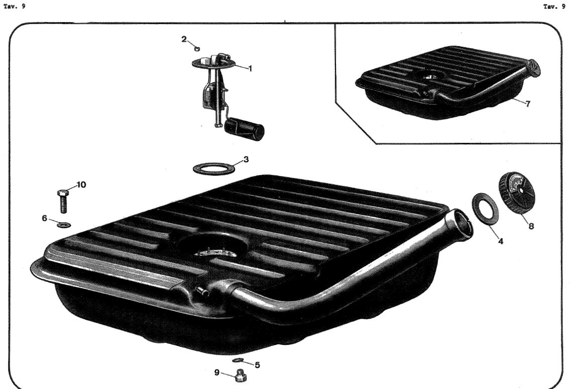

under the trunk carpet you will find the sending unit.
Dismount it, and test its working.

......it might be the float arm blocked (by rust or dirty) or the float sunk; As already suggested the best is dismount it a take a look.
