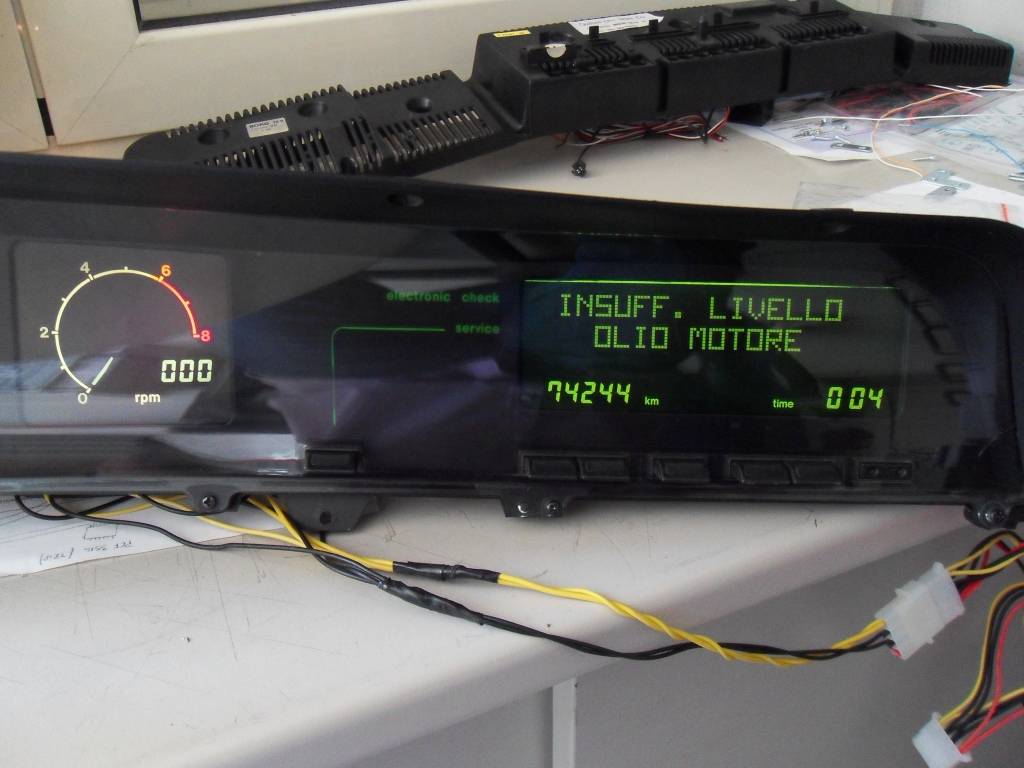

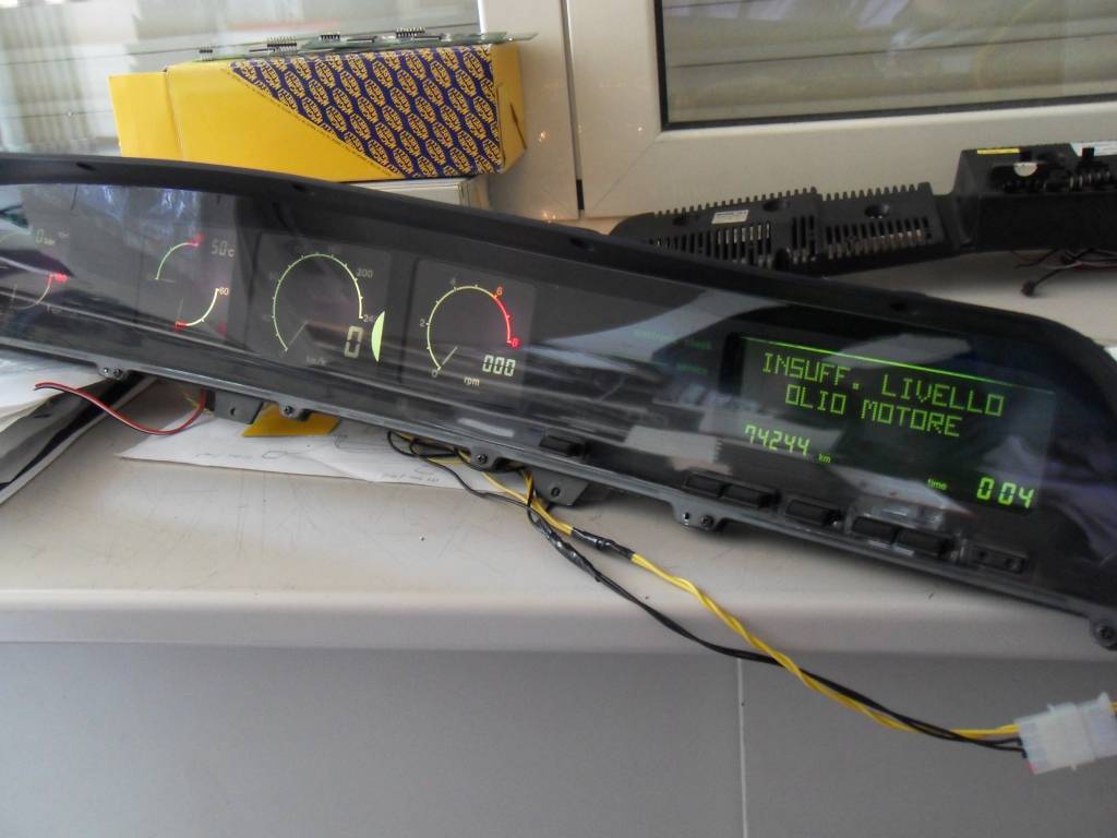

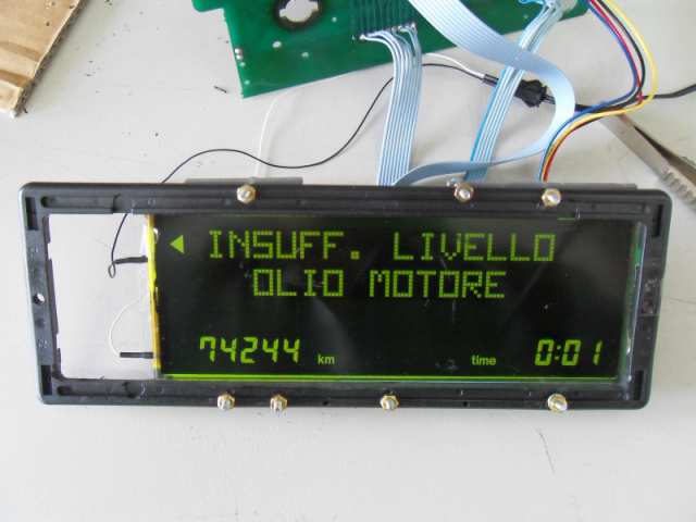

Re: Display for digital dash
Hi all
Just today i completed the job on the "check control" module.
The module was dismantled in all its parts and installed in a plastic support.
Yeah mates, no more halogen bulbs, no more fpc cables, no more unreadable text.
The new check does not heat and not stand the heat....and its free from shock vibration.
Here are some photos...
Best regards
Maurizio - Italy
PS: of course, the last task will be to use a bi-component for plastic....

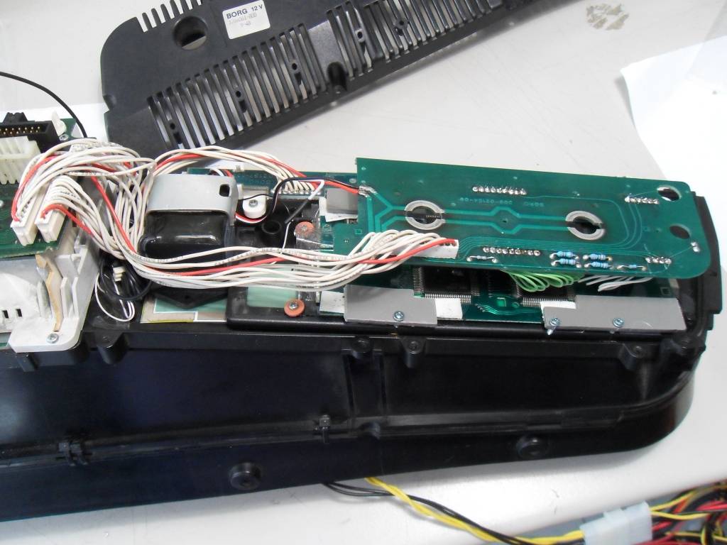

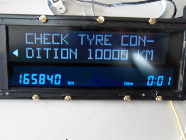

Hi all
Here are some more pictures of the module check, that i installed in the dashboard (final work).
best regards
Maurizio

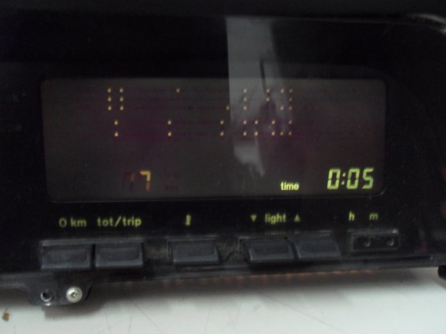

Re: Req: Display for digital dash
Hello there

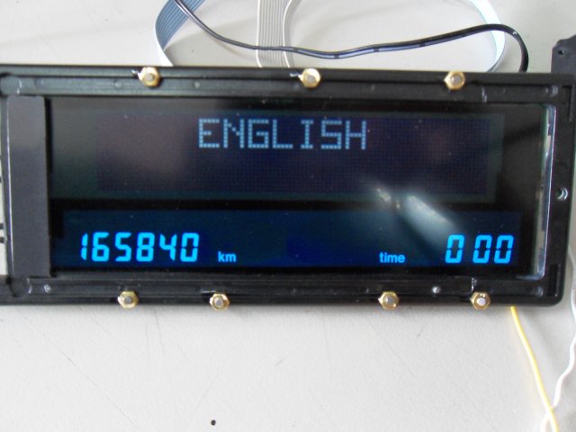

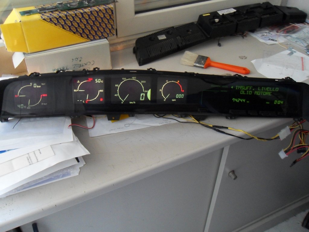

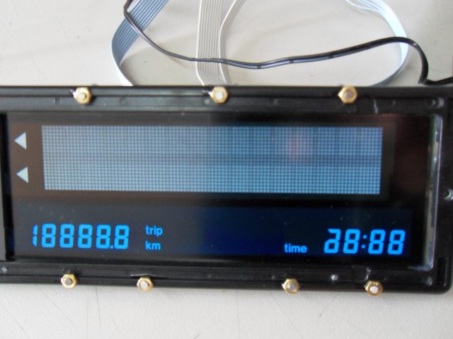

Just I repaired another digital / optoelectronic dashboard of a Lancia Dedra 2.0ie.
The electronic check was malfunctioning (see the photo), and i fixed it using strips.
Also i used two backlights, white color for the text messages and bleu color for km/tot - time.
Of course, for this repair I will post a video on youtube...as soon as.
Best regards
Maurizio
Best regards
Maurizio
