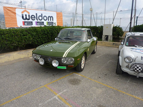

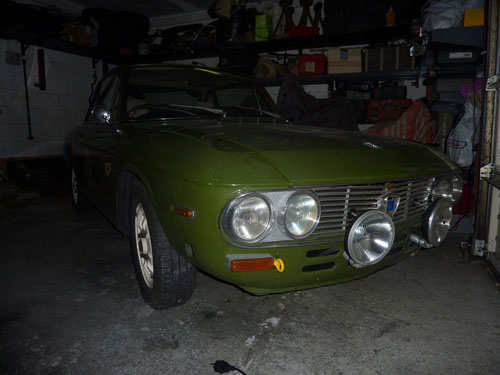

Dear Fulvia enthusiasts,
I'm looking at a beautifull green Fulvia with (original?) white striping, which is advertised as a S2.
The model year is 1974, but I'm not sure which month.

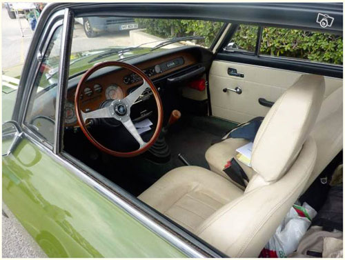

I have noticed it has the white dials, and green carpets. Does this mean it is an S3, from the Fiat era?
I asked the seller, and he sais he has always thought it was an S2.
The asking price is 8000 euros.
It's a 1300 km drive to go and see the car, so I'd like to know as much as possible before I make an appointment with the seller.
Best regards,
Jeroen (from Belgium)

Looking at the white dials, the head rests and the year I would say it is S3.
Technically there is no S3. It is more a marketing thing than a technical indication. The S3 and S2 have the same 818.630 number, the same parts manual, the same workshop manual. The only difference are the white dials, head rests and carpets instead of rubber mats. There is some debate about the grille. Might be silver for all S2 and black for all S3.
On early S2's you find some S1 parts (wishbones, inner CVJ's, rear spring mounts) but these have already gone on the later S2's and I am not sure they changed all those parts at the same time.
The take over by Fiat was I believe in 1969. The S2 went into production in 1970. I doubt if Fiat had much significant influence on the S2. The whole car industry was changing rapidly in those days. The manager was just invented and that was and is a world wide disease.
If you want to know my personal feeling about that car, you have to send a PM which you can do in Dutch.

Re: Is this Fulvia S2, S3 or S2,5?
The interior is S3, and if 1974 is correct, that is O.K.
There are no real Quality differences between S2 and S3, both from what you call Fiat era.
Nothing wrong with a series 2 or 3 Fulvia. Both true Lancia's and mechanically easier to handle than the S1 in my opinion.(Brakes)
