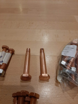

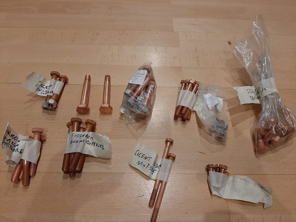

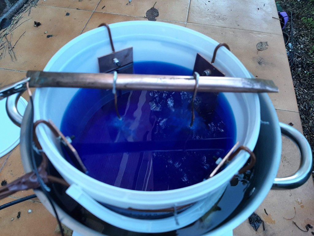

I totally second Huib that S1 hardware is very durable. I still had to replace/restore it on my FZ s1, and while I do now know for sure which bolts were copper plated and which ones were zinc plated I went ahead and copper plated most of the ones that had copper to start with. Some others fell in the plating bath too...
I couldn't restore all the bolts, so I sourced new bolts of the correct sizes and then applied alkaline copper plating on them. It has to be Alkaline plating becuase it adds very little thickness compared with acid one, and so it preserves the threads. I bought my plating kit from Classic plating in the UK, and the results are really good.
The bolts I sourced were blued, so I had to remove blueing and oil before I could plate them. It's not a short process, but the results are worth it.
