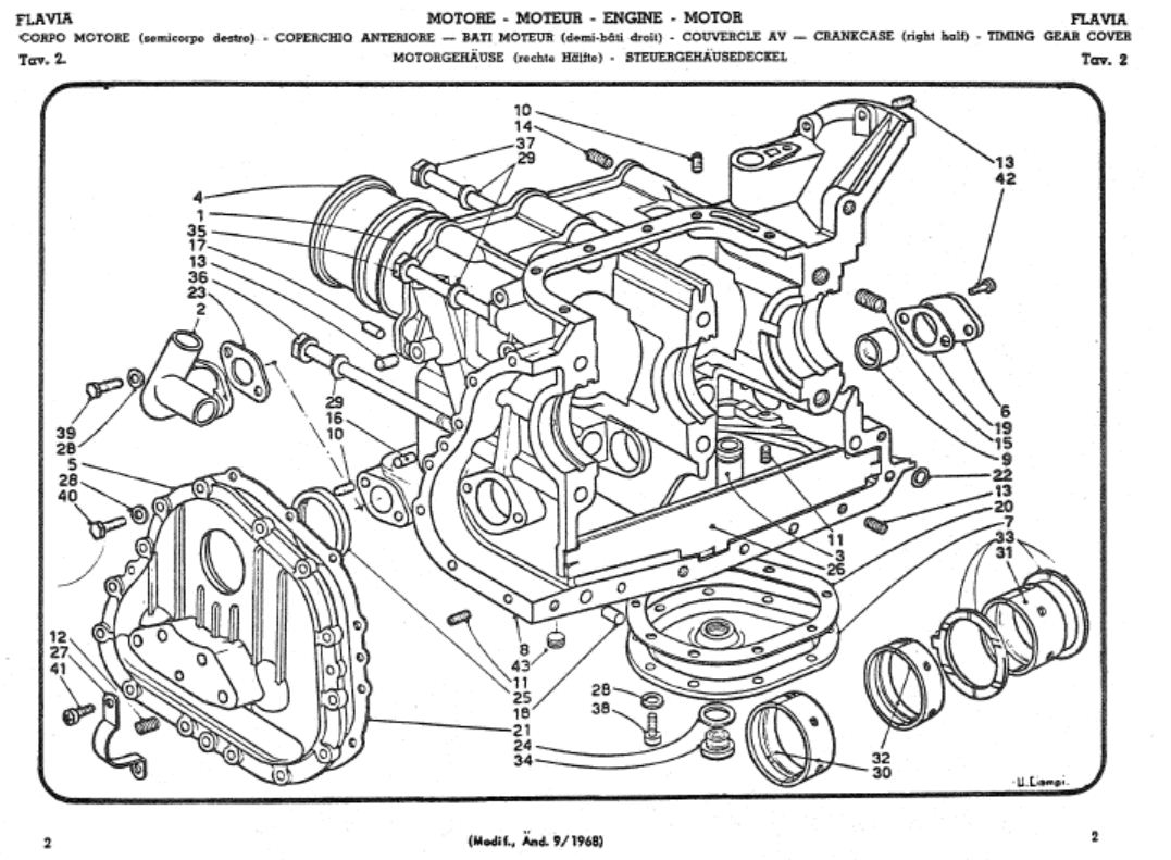

Perhaps the separation sheet was left out in your engine, see attachment part nr 26
