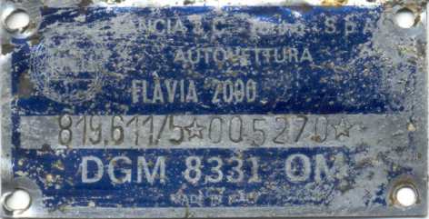

I have also wondered about the /5 chassis designation. When I was UK Lancia Club Librarian, and afterwards, I collected many chassis numbers and have records of cars throughout the 819 Flavia saloon range and the 2000 820 Saloon range with the /5 suffix to the chassis type. I used to think that it meant 4-speed or 5-speed gearbox, or possibly some other option like power steering or final drive ratio, but now, after studying the parts book carefully, I have noticed that the saloon Flavias were offered with an option for individual front seats, instead of bench seats. This would mean the car was a 5-seater rather than a 6-seater (3 in front, 3 in back). This is of course a guess.
In the case of the 820.211/5 for which I have a record, this could indeed mean a 5-speed and reverse gearbox. When they first came out they had a 4-speed and reverse gearbox.
Weernink's books give no clue about this, or any other books I have.
I attach an image of my Flavia 819 chassis plate (long-since scrapped), and this car did have separate front seats!
For the production records for the Flavia models, have a look at the factory records up-loaded not long ago to the http://www.viva-lancia.com/specials/cd/vin.php website.
Perhaps someone in Italy knows about this for sure.

I think your assumption about power steering matched at least in my case. There had been power steering in the Berlina with /5 designation. The options of bench seats/individual seats are very probably
binded with the location of gear shift lever, and that is designated in VIN: 819.x00 for column shift, 819.x10 for floor shift.
