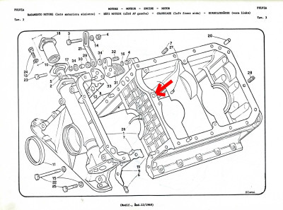

Dear Huib,
I know it is an old thread, but I have just found it. I will need to prepare a new low-end for my Fulvia, so I am really interested this information.
"Maybe the "hidden" bolt fastening the cylinder block to the crank case was forgotten or not properly torqued."
Clould you please let me know which is the "hidden" bolt?
Thank you in advance, Peter

Re: Inspecting bearings without removing engine
It sits where the red arrow points. It is all the way down in the cylinder block. Not really hidden but if I ever forget to take out a bolt, this would be the most likely candidate.
