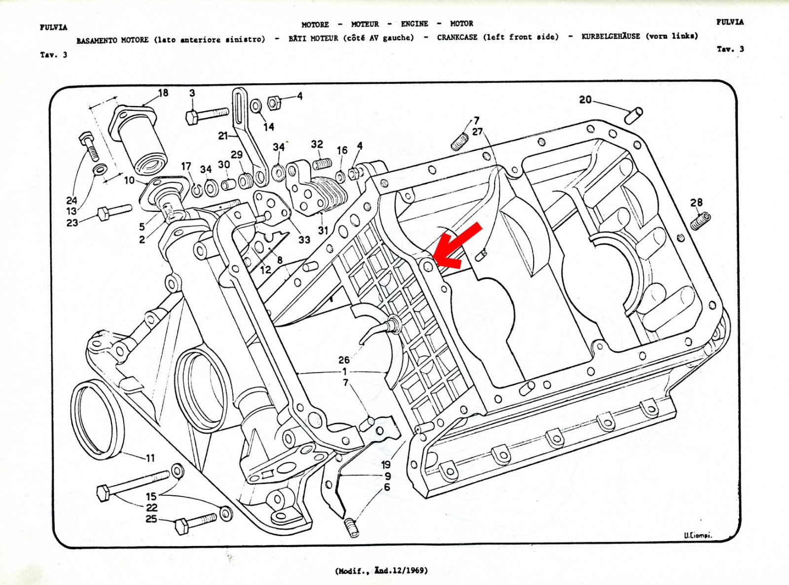

Dear Huib,
I know it is an old thread, but I have just found it. I will need to prepare a new low-end for my Fulvia, so I am really interested this information.
"Maybe the "hidden" bolt fastening the cylinder block to the crank case was forgotten or not properly torqued."
Clould you please let me know which is the "hidden" bolt?
Thank you in advance, Peter
Huib
Site Admin
Posts: 1884
Joined: 17 Dec 2008, 10:12
Re: Inspecting bearings without removing engine
Unread post by Huib »
It sits where the red arrow points. It is all the way down in the cylinder block. Not really hidden but if I ever forget to take out a bolt, this would be the most likely candidate.
