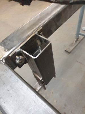

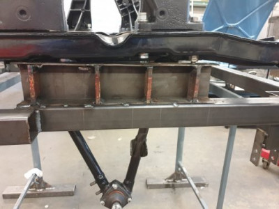

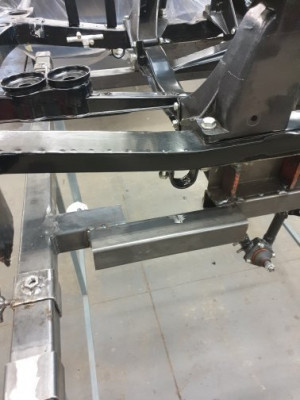

I made some photo's which I will upload in one or more postings. I will see how it goes.
Playing a bit with it to get the feeling, is the best you can do. Brilliant. Once your jig is in order you will see it is probably easier than you thought.
The only parts that do not flex are the two alloy towers. Also the construction of the two towers with the three cross members is pretty solid. That is your “center of universe”. It is sacred. In a manner of speaking course. The car is put on top of the towers. The large subframe is to keep the thing up right.
What are the options? Here is one.
Put the car up side down. Mount the towers with their rubbers in their holes. Align the towers and cross check. Place the subframe on top and check that all the bolts fall freely into their holes. The bolts are the 8 pcs M10 bolt and the 4 pcs M12 bolt. And check all the off sets.
Then bolt the three cross members (1 at the top, 2 at the bottom) between the towers. Check all dimensions. Put the assembly on the car again which is still upside down. Check that again the bolts go in easily.
The support for the subframe at 80 mm'. It is rather strong and good for bending work at the out riggers.I do agree with bmarler that you should bolt in the rear cross member. There is play on the bolt holes. You have room to adjust that the two cooperate.
Hanging up side down is the bracket to hold the rear of the sub frame in place when cutting and welding has to be done. We can also slide on supports for the 2 mounting holes at the front and the two outriggers. The slide-on's are for measuring up side up or up side down. Others are for clamping either way.

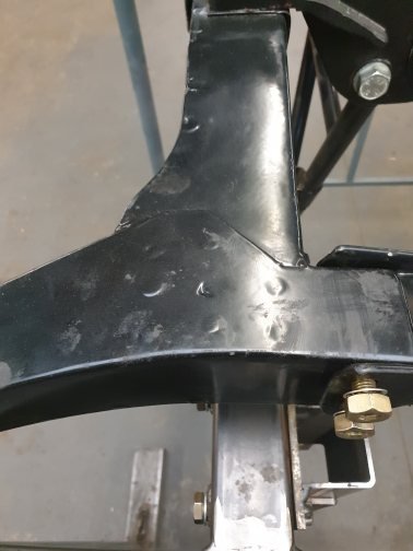

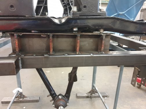

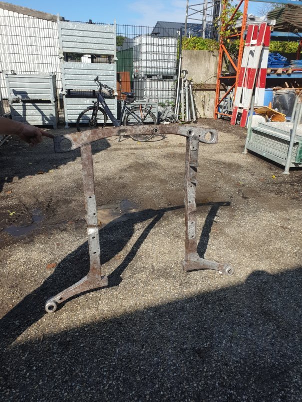

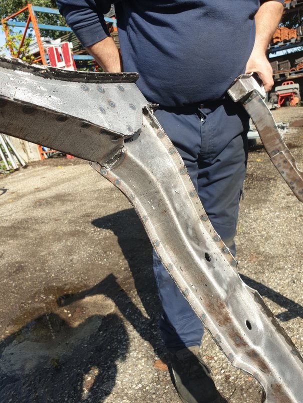

Here a pic of the sub frame which is now being built up on the table.
Below some pictures of a sub frame of one of the cars we are now working on. The car is a 74 coupé from Napoli. It was in storage for most of the time. The sub frame is unmolested and no rust. We soda blasted it. The factory did put the black paint directly on the steel. We put an anti rust primer and on top nero semilucido. We developed that paint to match the shine of the black the factory used. Putting the extra layer of primer makes it necessary to re-torque all bolts after a few 100 km. We think it is worth the trouble as the protection is quite good for the climate here in the Netherlands..

My pics show 2 different sub frames. On both the spot welds are original. I have never had problems with the spot welds on the sub frame. Replaced many outriggers though.
The black sub frame was powder coated 15 years ago. It pieces chipped off. It was warped and needed other corrections including welding. We took the powder coat off with the rotating steel brush and hand painted with a rather expensive paint.
I going away from the powder coat.

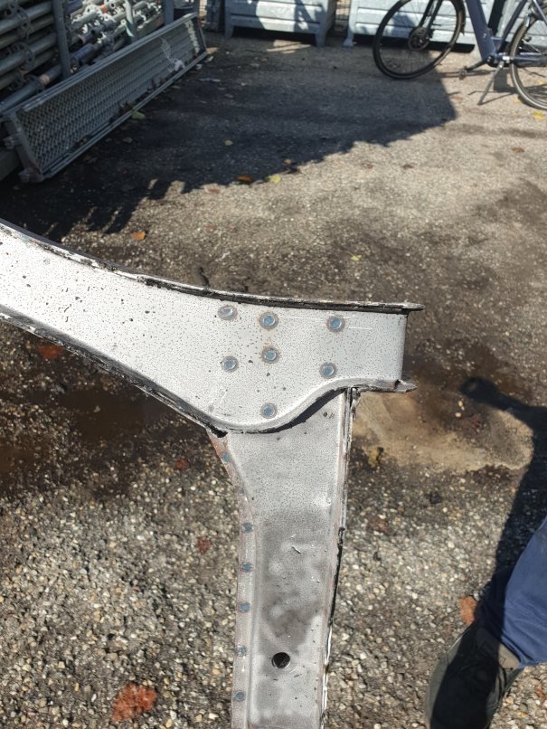

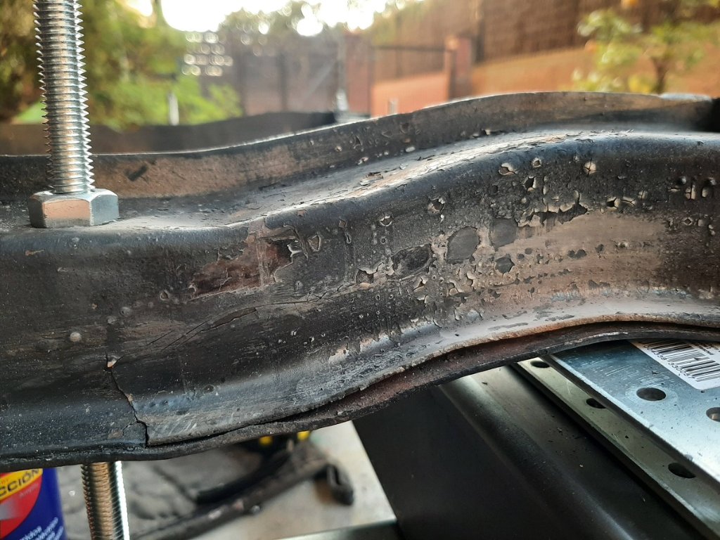

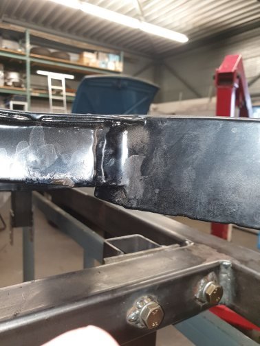

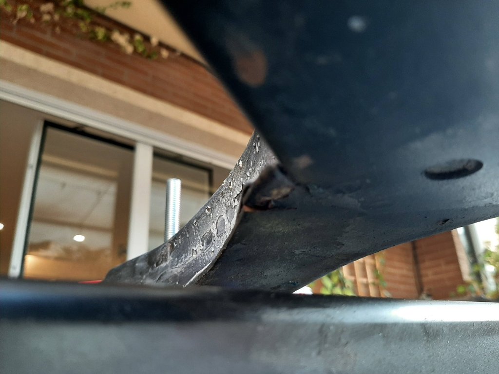

Here are my spot welds and cracks, not a pretty view:
Racing is clearly very hard on the whole body. On the spot welds the 2 sheets were already separated but more like sliding on top of each others, not splitting. When I bent back the outrigger they opened up a bit. The cracks were already there.
I need to bend the upper (in the figure) sheet metal back to overlap the bottom one and weld it. Then take care of the 2 cracks. I will most likely make a hole at the end of the crack to stop it, weld it and then weld a gusset on top of the weld extending 3-4 cm both ways. I think it would make sense to add a simmetric gusset on the other beam too.
I'll keep You guys posted.
luca

Oops. Looks like someone butchered it. My nipotina who turned three a month ago would have done a better job but she has different plans.

I had the feeling the subframe had been fixed before. There is a fair amount of weld spatter where the outrigger joins the longitudinal beam, but I can't really tell. The crack by the outrigger seems to be coming from there.
The other crack (the longer one) is right at the limit of the last spot weld that failed. My theory is that load on the outrigger twisted the beam, and bent inward the sheet metal up to the point where the spot welds gave up. This outrigger was 15mm lower than where it should have been!
I have been looking for another subframe, but I cannot find any good one in Spain, and I would need to have it shipped form Italy. The ones I found all look pretty nasty and they will need some degree of repair anyway. If I could find a good one I would go for it!
