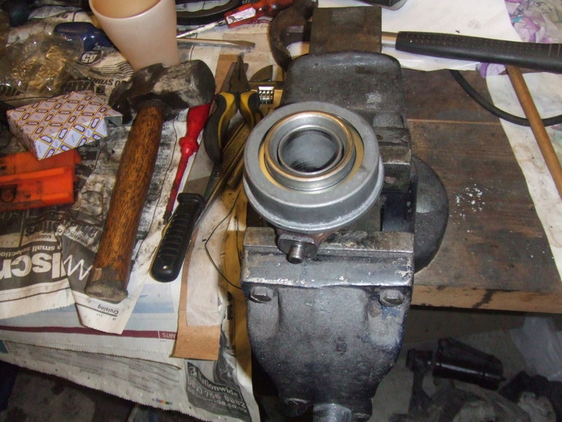

Mine's a diaphragm clutch. The release bearing looks like this:
release bearing 2.jpg (143.24 KiB) Viewed 490 times
release bearing.jpg (20.12 KiB) Viewed 489 times

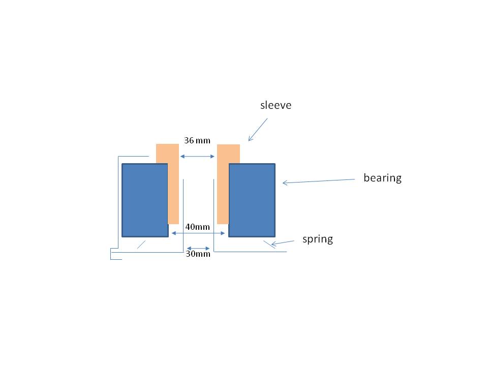

The bearing code that I got is 6007 not 6008, the 6008 is too large, has anyone had any experience with this? S2 Coupe release bearing....
The guy at the bearing supplier says that the "sleeve" is actually part of the bearing, specially manufactured for the car. He did however say that I could knock out the "sleeve" then have machined down and pressed in to place in the new bearing...
Any thoughts?
