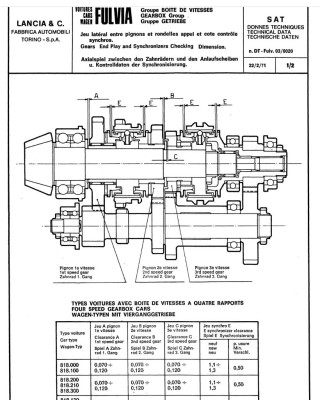

Measure the play E. If it is more than 1,1 mm, the synchro is new. If it is 0,5 or less than it has worn and needs to be replaced. Note, I mark the synchros so I can put them back in the original gear.
You can nevertheless play with the synchros. Suppose the one on 2nd is 0,8 and the top one (nr 4) still is 1,3 than swapping them is an option. Apparently the one on 4th does not wear. Putting a 0,8 one is thus no problem. And you can put a "new" one on 2nd.

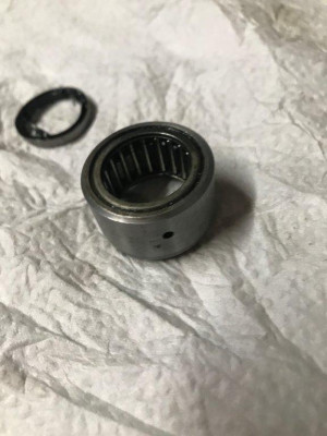

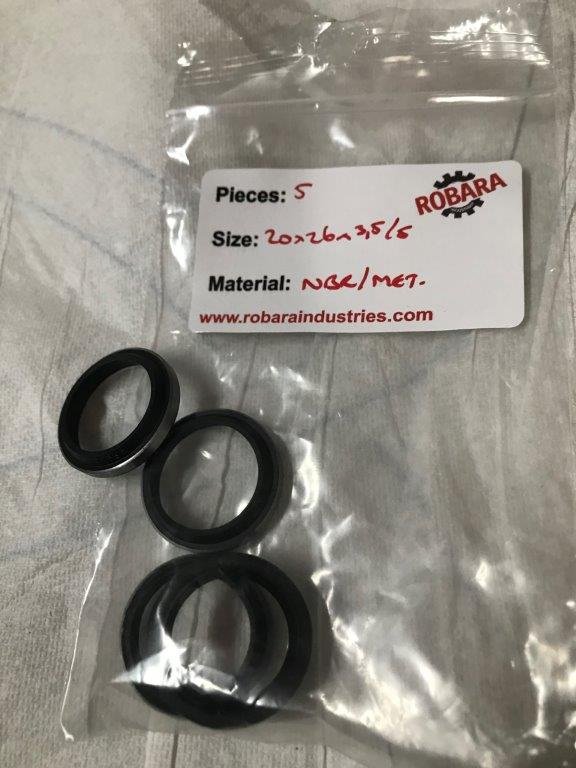

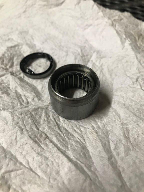

Yesterday I remembered that the second seal was already a topic in the German forum two years ago.
You can find what you need here in the pictures.
Regards Andreas
