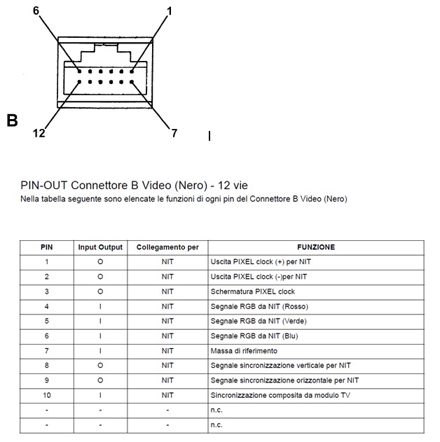

Today the EGA to VGA converter arrived. It even came with connection cables! I also found the explanation of the plug of the screen in the manual. This is the picture:
- stekkerb.jpg (80.79 KiB) Viewed 459 times
Re: CarPC project by vlad47 step-by-step
I have also the picture (made by myself) explaining the other side of the connector. Can make a photo if you like.

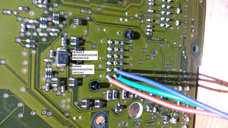

@Vlad47; the connections behind the black connector from the manual differ from the pictures from your friend. I'm a bit confused now. Eg the line marked Rosso in the manual is number 4 and here your friend doesn't mark this connection but has the horizontal synchronisation next to it. Somewhere there is a mistake. Is the manual wrong?
