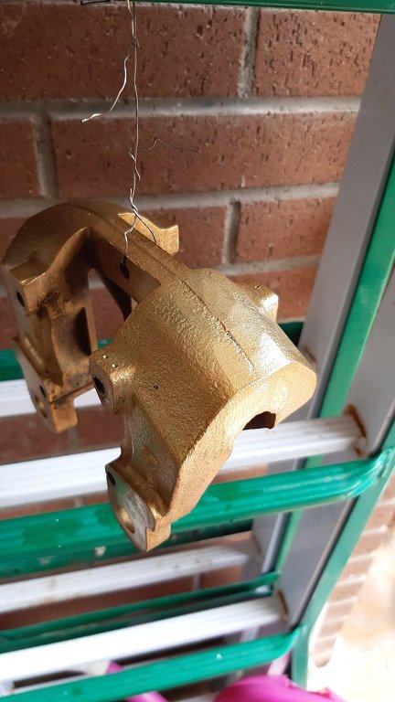

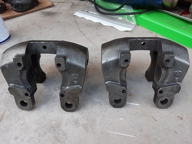

I figured out by myself that Zinc plating is quite tricky, no matter what youtubers say.
I also had mix successes, but preparation is key as well as overall cleaness. Doing it only form time to time makes it more challenging and I believe with a well built set up (with filters and agitation) one stands far better chance of success.

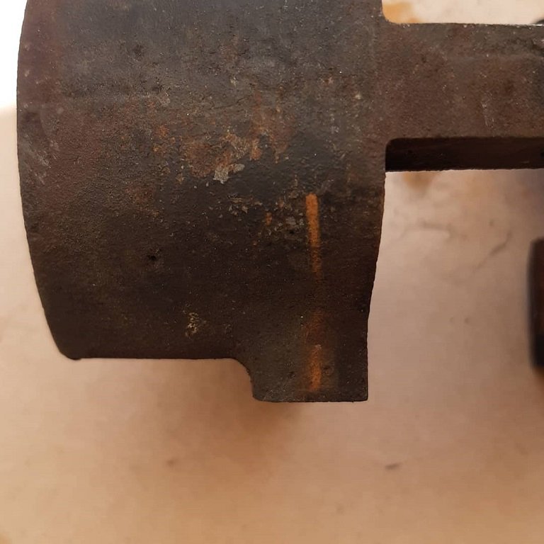

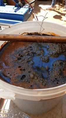

I used it on the calipers, that I first cleaned with electrolisys. Electrolitic cleaning is fantastic and works every single time:
Cleaning by electrolysis is great because it only removes rust, no iron is removed by the process.

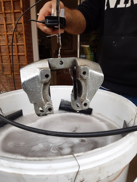

Next is plating:
the issues here are that plating may become dull for multiple reasons (electrolyte cleaness, high current, lack of brightner...), and it doesn't reach as well areas that are shielded. I'm planning to build a set up that keeps the parts moving all the time so that there are more chances for the zinc to distribute evenly.
At last the chromate layer:
While it sonds as simple as dipping the parts in the chromate, the reality is that it is not. PArts need to be thoroughly cleaned before they can be put in the chromate, then they need to dry for a few hours and it's much better done at fairly high temperature. I use a dryer until all droplets are dried and then leave them in the sun. If You touch them, or move them, or wet them during the first 8 hours or so the chromate reaction will not occurr and the zinc will be exposed.
In a nutshel what I learned is that what people charge for plating isn't enough to making it right, and that even then results may not be perfect because we are dealing with old parts with inevitable surface damage. I try not to use it on bolts because I don't want to risk H2 enbrittlement if bolts can be sourced anyway.
