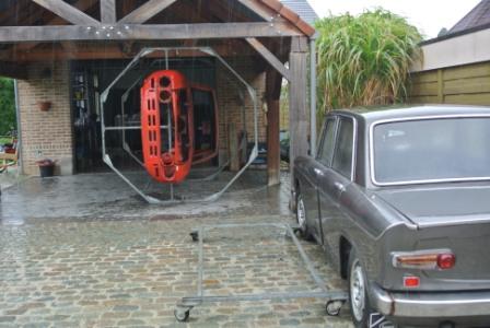

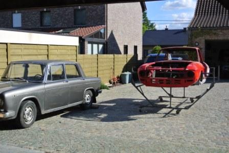

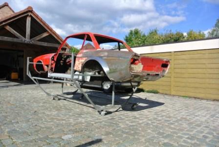

- 086 - kopie.jpg (53.18 KiB) Viewed 458 times
- 102 - kopie.jpg (53.03 KiB) Viewed 458 times
- 099 - kopie.jpg (54.36 KiB) Viewed 458 times
