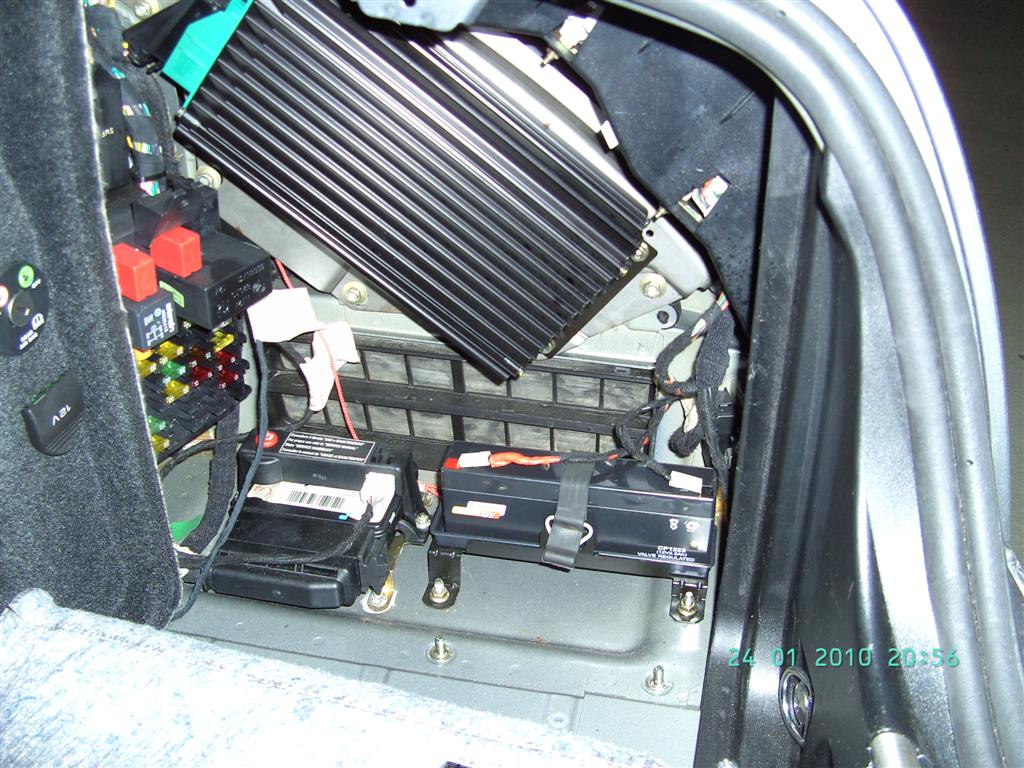

Dear Teja,
There could various reasons for the problem with hand brake, and the hand brake battery (located in the trunk) could be just one of them. If the battery is the source of the problem, a warning light (a yellow triangle) will turn on the dashboard. The best way to proceed is to connect the car to FIAT Examiner Diagnostic, in order to determine the source of the problem.
Sasa
Sasa
Re: (Hand) Brake
hello teja
once more time for you, please use this page !!!!
http://www.thesis-treffen.de/
all the problems with the hand brake you can read and tell
jour garage.
see the connection of ABS steering
see the same for EPB-- steering. unlock the connection.
good luck
