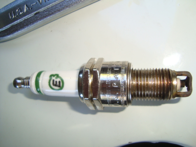

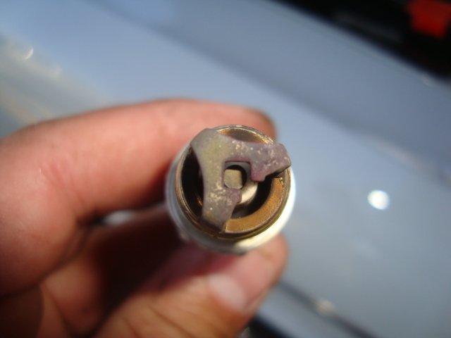

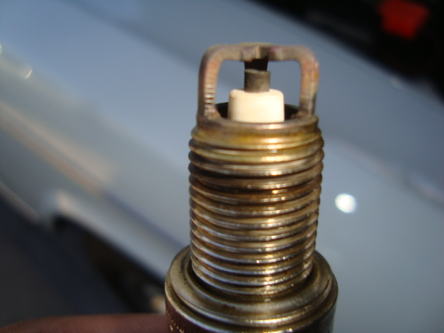

Hello I just wanted to pass on my experience with E3 Spark Plugs at the beginning I was very skeptical about how it was going to perform and if I was just to waste my money and perhaps damage my engine. but not at all it has improve alot how my engine runs by far. When I first install them the RPM went from 1100 jump to 1700RPM, I adjusted the idle back to 1100 and drove the car for 5 miles, check plugs very lean, add fuel to mixture, RPM Jump again to 1800. drove 5 miles. again adjust the idle to 1100. I did this 4 times I move the fuel mixer screws about 90 degrees from start. adjusted the idle 4 times. now it drives super efficient the exhaust smell very clean non toxic. and the same for 1.3 & 1.6 engines run very smooth. Now I have the timing advance, all electrical new parts, new carburator mount etc. here is how the spark plugs look after 30 miles of use. my advice if you are going to change this in your car get ready to make the necesary adjustments.
