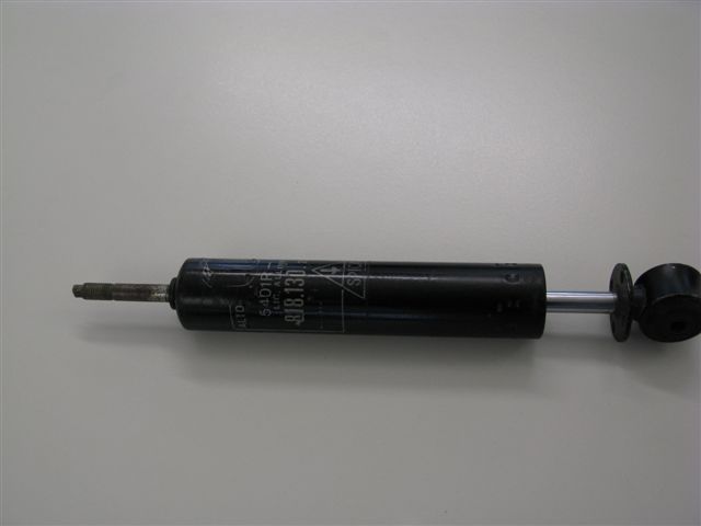

SPICA shocks were made under license from Allinquant and, as Andreas says, involves a different design principle. But the SPICA shocks that Adan is looking at are a later evolution than the one Andreas describes. A DeCarbon patent monotube shock has a second, floating piston that separates the oil chamber from a nitrogen-filled gas chamber. This Allinquant patent was a monotube with "gas pressure" in the form of an inflatable rubber air bladder at the top, above the oil; the rubber membrane performing the same role as the floating piston in an De Carbon. Sort of. Simply no comparison in sophistication or function.
Re: Lancia Fulvia S1 coupe Shocks Spica vs De Carbon
The Allinquant version is the same that spica use. Only different is the Gaspressure.
regards Andreas
regards Andreas
- spica_818130.jpg (18.82 KiB) Viewed 670 times
