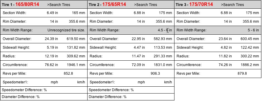

Re: tyres/rims - any final thoughts?
Ok the final decision: Either Michelin Energy Savers (73 euros each) OR Firestone Multihawk (63 euros each)
Any thoughts on the Multihawks - I'm not too familiar with them.
So 175 x 14 will be the size BUT what should be the profile?
Attached is a comparison between 3 different size - so what is the safest bet?
