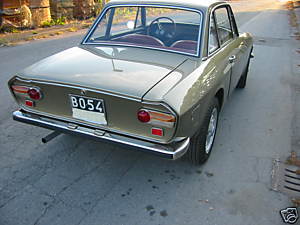

I've been meaning to ask about this phenomenon. My S2 has a rear end hop which I probably made worse by removing the spare tire. I suspect this is something one grows to live with due to the innate lightness of the aft end and the leaf spring design but I would be interested in viewpoints on what to check for and optimum air pressures and shock settings/types to minimize it. I haven't inspected the shocks for brand but suspect they are stock type and maybe the originals. I haven't even had the time to put the car in the air since I purchased it this past fall. The tires are Michelin Energy 175/70x14 on Campanolo wheels and I run about 30psi. Also I spied a ratchet setting on the axle at the mid-point just now for the first time. Has this got something too do with it? Do the manuals address this setting? Thanks in advance. Rick
