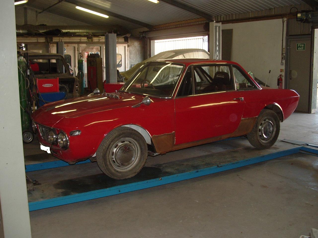

Just about to start dismantling
- fulvia s1 003.jpg (178.11 KiB) Viewed 1026 times

Looks like a well equipped workshop.

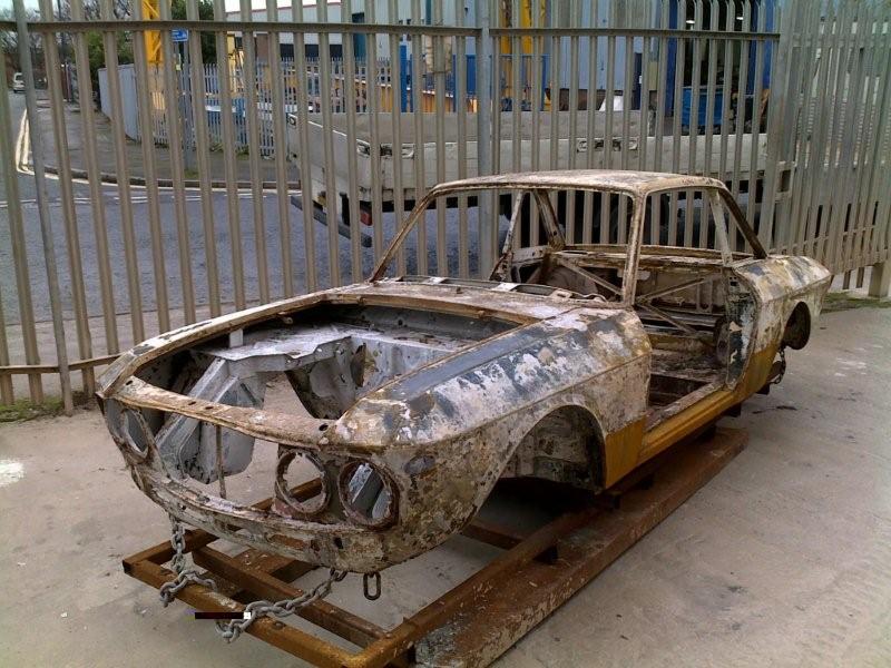

Series 1 Fulvia after thermal processing to remove paint, underseal and all sealants.
Scarey moment.
Scarey moment.
- lancia fulvia.jpeg.jpg (97.4 KiB) Viewed 1026 times

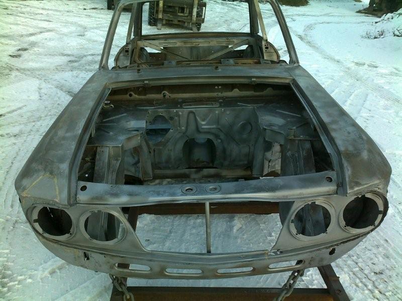

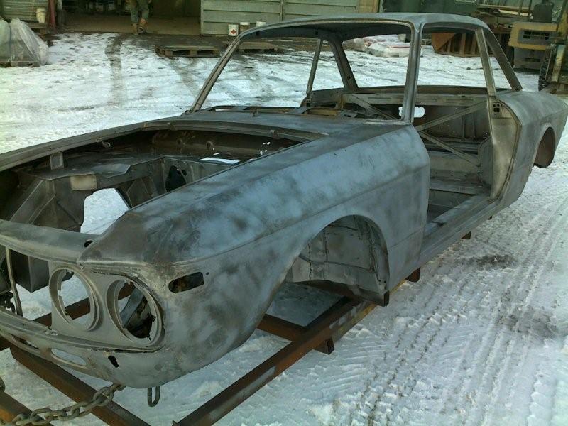

Looks a bit better after a clean up.
- 21122009135.jpg (83.25 KiB) Viewed 1026 times
- 21122009132.jpg (85.26 KiB) Viewed 1026 times
