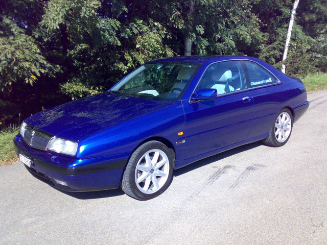

- 20092007020.jpg (103.18 KiB) Viewed 489 times
