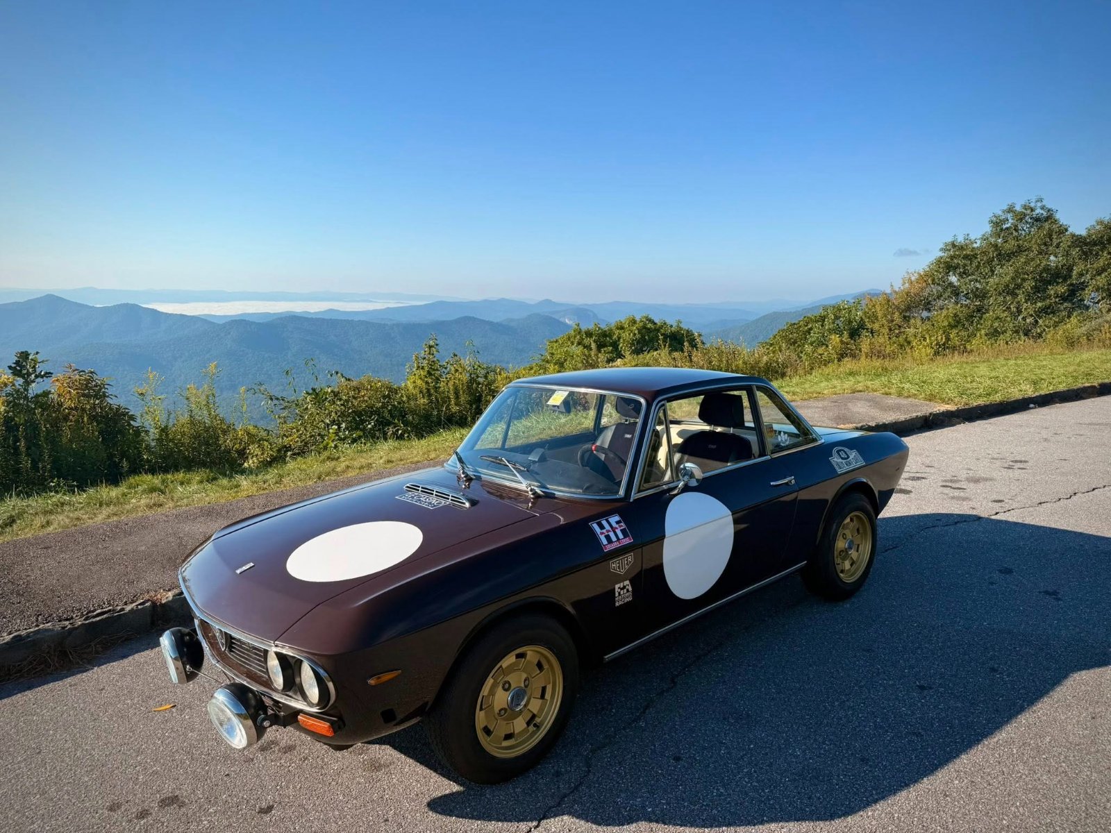

I grew up in the UK loving the Fulvia and finally found one in the last few months and could not be happier! 'Bruno the brown car' is a 76 Fulvia 1.3.
