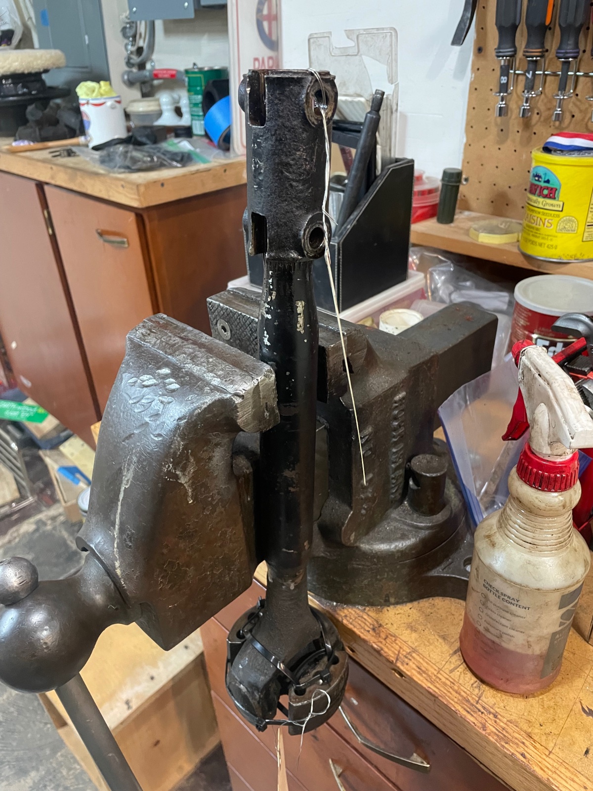

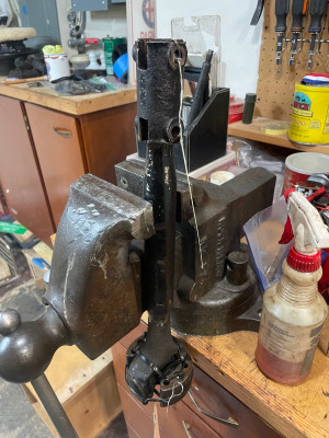

1) The hubs need to be in the same plane.
2) The sleeve never moved off its position on the axle, but was removed from the yoke by,
3) Undoing the four nuts holding the outside u-joint and pulling the axle thru the hub.
I used a plastic wire tie to bound the u-joint caps in place prior to removing it so the caps wouldn’t fall out and then once removed added a few more thru the caps to keep it all in place.
Currently sitting over night in a vice to allow the oil to soak on and will fully remove the sleeve off the axle tomorrow.
Hopefully this technique works for the other side as well.
