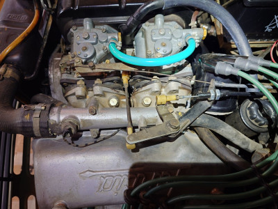

And can you post a picture of the throttle and choke cables?

Attached a photo of throttle and choke cable. The throttle cable is new.

Well, apart from the sounds it is also the sequence.
The material of the throttle cable, its routing and fastening of the outer cable to the firewall have to be correct.
The engine tilts from left to right and vice versa. The subframe tilts from front to back and vice versa. The throttle cable needs to form a wide loop and be flexible enough to compensate.
I can't clearly see how the throttle cable runs or how it's attached to the firewall.
There are two rubber rollers behind the throttle pedal. Are they there and are they OK?
What is the clearance on the 3 white plastic connecting pieces?
Is the right engine mount (under the air filter) properly adjusted?
