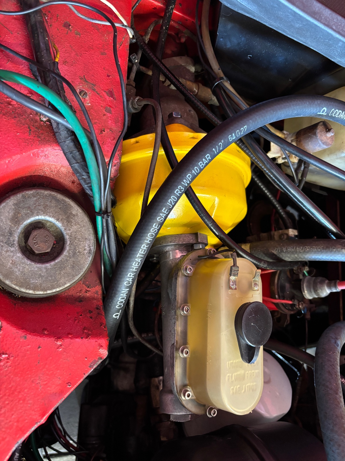

I’ve recently recommissioned a 1970 series 1 Fulvia after 7 years in a shed. A previous owner had fitted a brake booster and Girling front calipers from a series 2.
I’ve had the master cylinder and callipers rebuilt, and fitted new hoses.
I’ve recently started to drive the car a bit further than around the block, and have now noticed that after around 20 minutes of driving, the front calipers start to bind and drag.
Unsure why this issue would only appear after a period of driving - happy to receive advice if a) anyone else has experienced a similar issue on a refurbished brake system, and b) can suggest a fix!

The usual cause is not enough free play between the pin of the pedal, in your case the pin of the S2 servo, and the plunger of the master brake cylinder. If the plungers inside the master brake cylinder are not allowed to go fully back to their rest position, the compensation hole will not open.
The brake fluid in the lines under the bonnet heats up and expands. Fluid should flow back into the master brake cylinder. If the hole is closed the expansion of the fluid will push the pads against the discs.
If it were my car I would bring it back to original.

The change to S2 front brakes was done around 30 years ago; the effort to revert back to frankly average Dunlop front calipers is not one I’m considering at this point.
Sounds like I need to split the booster off and check actuating rod lengths…

The S1 master cylinder has been replaced with a (freshly overhauled) S2 MC and the addition of the brake booster.
Braking performance has been satisfactory (and, by the look of the removed corrosion from the discs now back in use, comparatively even front and rear). The only concern has been the front brakes starting to drag/lock on after 20 minutes or so of driving.
I will report back after adjusting the reaction rod by a millimetre or two.
