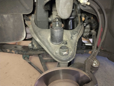

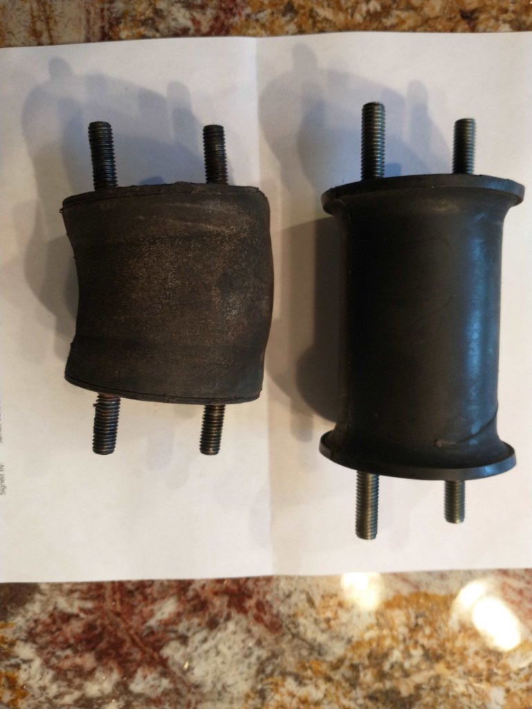

Downsized the images on my computer (site still returned an error for file size being too large).
So here you can see the old and new buffers, and the left buffer installed. Really happy with the attitude of the car now and the clunk from the torn lower shock bushing is gone.
