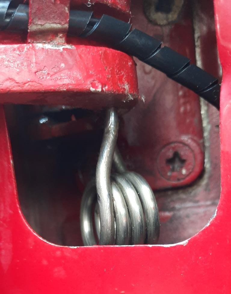

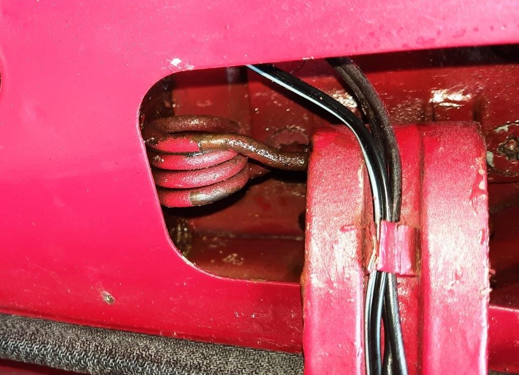

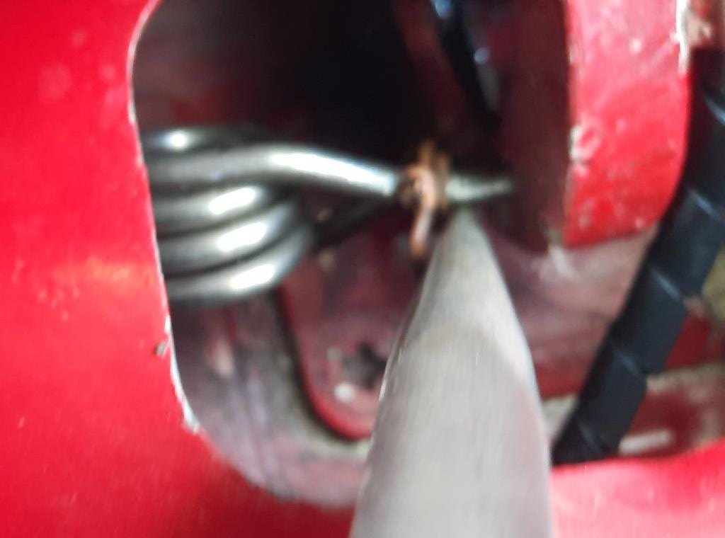

Hello
I dit it ! without moving the door (except to open it)
I had a spare part of door hingle
so I tried to put the nex spring on it, but it was clear that the spring ends had to be close to get in place
I put the spring on a vice and get them to 1 cm (inner distance). One end hat a "hat" and go to the fixed part of the hinge, which has a notch on the side, the other end has nothing and go to the moving part
To keep them in this position, I tried different ways; the better was a bronze wire, about 1mm diameter and 2 turns around the ends, and twisted to stay in place, as close as possible from the spring turns
Then it was not difficult to get the "hat" end, just open the door half way to set it in the notch
The other end did not come easily in his hole, so I used a long plier to keep it and gently colsed the door until the hole come just above the end of the spring.
