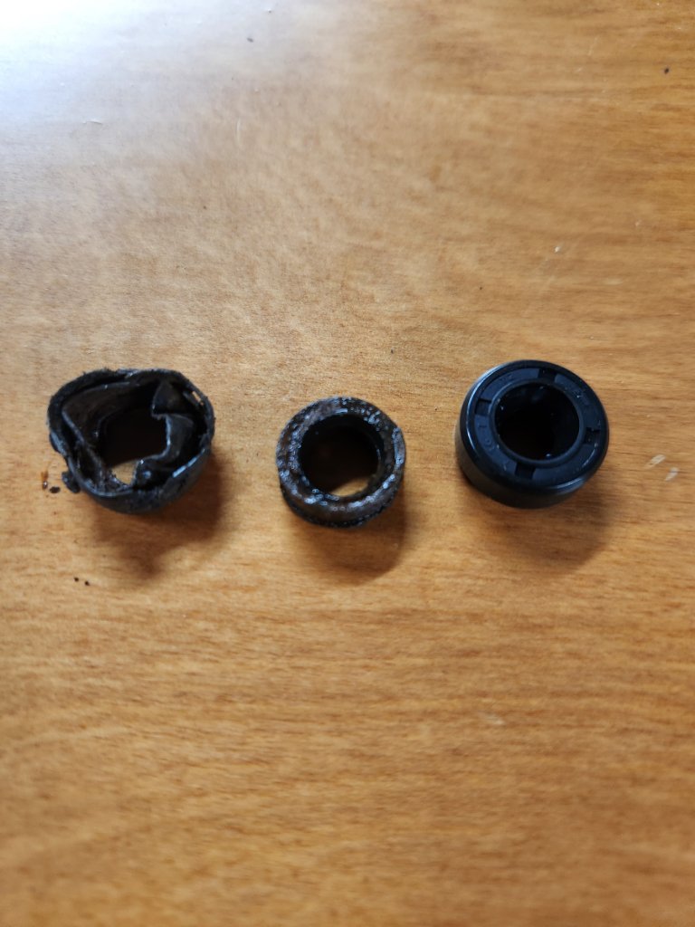

After a few hundred kms no oil leaks visible: I replaced the two front seals and the sideshaft seals, as well as all the gaskets. I put some sealer on the surface inside the half shafts where the nut seats. Also replaced the small oil seal inside the speedo drive - see attached - that has clearly never been replaced!

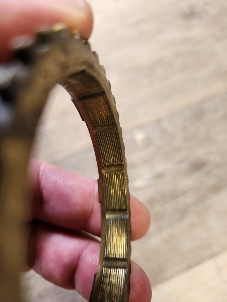

Best of all, my second gear downsift issue is fixed! Have been nursing that for 10 years... The syncro was basically brand new, but has clearly not been lapped when installed by a gearbox shop previously. From the shiny and dull marks in attached picture you can see the inside of the syncro ring did not fully make contact with the cone. After lapping with grinding paste for about 30 second the "grip" on the cone drastically increased. There is now no delay or grinding when shifting (down or up) into second, even when cold!

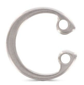

Oops. You absolutely need 3 in each flange. Loosing one is normal when you dismantle a Lancia gearbox for the first few times. What you can do is follow the system of the series 2. Use circlips:
