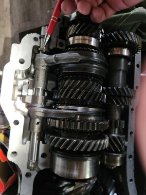

I'm about to open my gearbox to replace the oil seals, but also because it drops out of 3d too easily when I depress the clutch. Great tips in this thread regarding the 3-4 slider that may be installed incorrectly.
The other issue I want to check is 3d to 2nd down shift that crunches, even when not really rushing it. 1st to 2nd shifts perfectly, even when cold. It has bothered me for a long time, as I had a new 2nd gear synchro and sleave installed years ago (minimal km's since then though) by a gearbox workshop (who I suspect also reversed the 3-4 slider). I wonder if the reversal of the slider on 3d may affect the downshift to 2nd? Sounds unlikely, but you never know.
I will measure the clearance on the synchros to check for wear. I will see if lapping the 2nd gear synchro might help if it is not worn.
Any tips for installing new synchros, or anything else to check that might affect the 3d to 2nd downshift?

Following this topic with interest - I was convinced that my car dropping out of 3d gear must be due to the 3d-4th slider being reversed previously only to find it installed correctly.
I am currently focussing on the selector mechanism. I will follow Marnix's advice and tighten things on the outer selector mechanismas much as possible without restricting movement. I have also added a small shim to the 3d gear spring on the inner selector and it feels like it clicks into third a bit more solidly now. I guess there is no way of really knowing if these springs still have their original tension and what to replace them with?
Also, what role do the springs in the synchro hub play, and are these known to need to be replaced?
While inspecting the inner selector mechanism, I noticed there is a machined shim floating freely at the rear of the shaft. This looks correct from what I can see in the workshop manual (not very clear). I noticed in the original poster's pictures that this shim is not present. Can that be part of your shifting issues?
