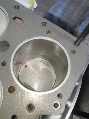

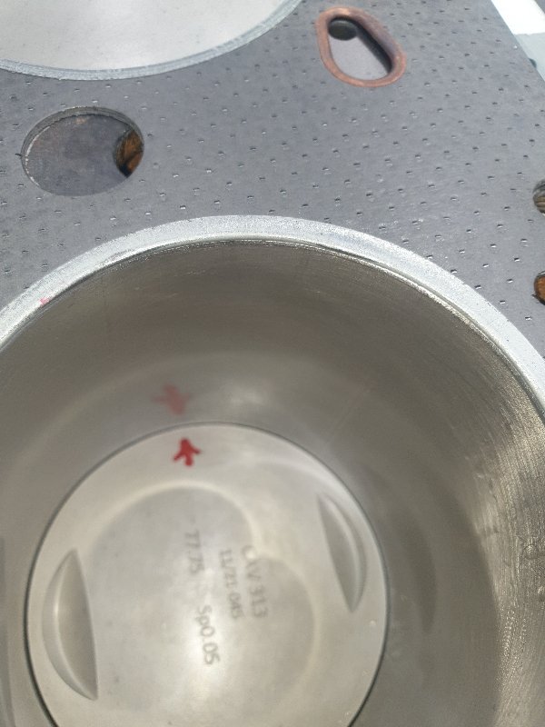

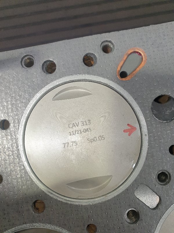

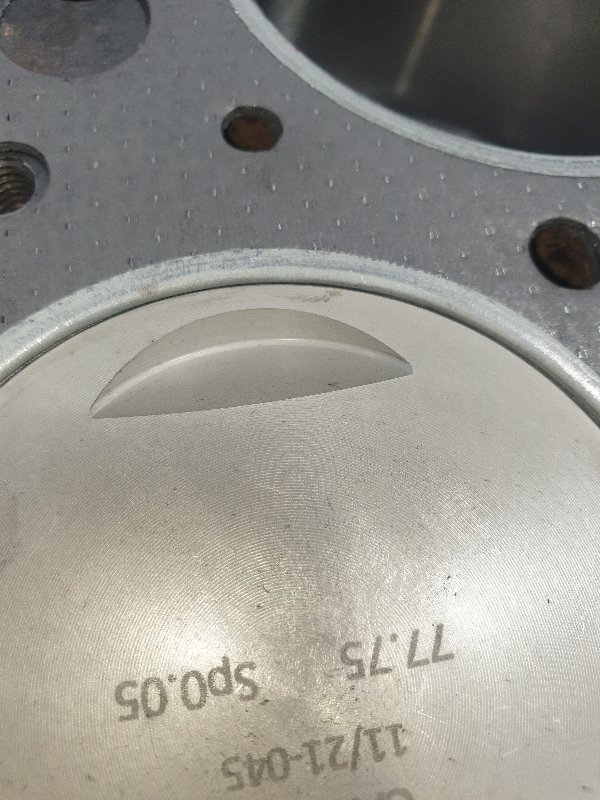

Hi everyone,
I am in the home stretch with the engine rebuild. The engine builder phoned me today with a question though before he can finish the reassembly:
The block (Series 1 1.3S) was bored to 77.8mm (0.8mm oversize) but the Spesso head gasket I have is very close to the bore size. Even though the pistons don't protrude higher than the block face, he is just worried when the gasket compresses that it might clip the gasket.
Is this an something to be concerned about, and if it is, are there head gaskets avalaible for oversize engines? I don't think I've ever come across different ones when buying parts.
Pictures attached.
Thanks!
