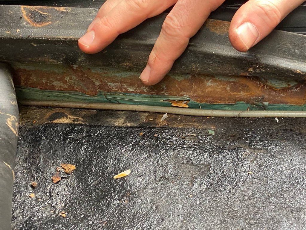

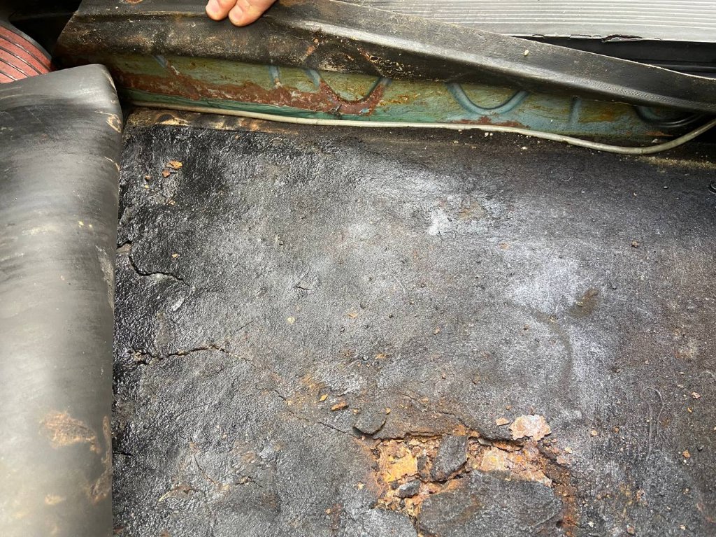

i had a look at this Fulvia today, and i am wondering what you think of these images. I am really unhappy about this.

Very good reason to make new friends. Be happy. We do a perfect job.
Note that there will be more. You need very good new friends.

thanks for cheering me up. The rest of the body seems fine, maybe some surface rust in the engine bay. I suspect more as well.
It sounds like you can help and want to be my friend :) Assuming only the rusty floor and rocker panels have to be welded: what would it approximately cost to get rid of the old paint and rust and put on a fresh coat?

It is impossible to say what the cost is going to be. There usually is a lot more going on than you can see from the outside. The sill structure is complicated and different from any other car with a lot going on behind the wings. Some cavities have no hole to let water out. Lots of rust guaranteed.
On average there are two earlier repairs which were done badly. If they were done rightly you would not have a problem now. We use the Mercedes system with lots of zinc between the welds. If the customer agrees we glue new wheel arches with 3 component kit to prevent rust.
Usually the car has had at least one and likely two accidents which were camouflaged and not repaired correctly.
Because of running too long with bad sills the car is most likely warped and bent.
There are some imitation parts available but none of them is entirely correct. It takes time to correct them and add the small nicks and bends to ensure over all strength of the car. Many parts have to be hand made which takes a lot of time.
In all likelihood there will be more rust. There also will be deformation, usually very well camouflaged. We cannot see it before we start a job. It becomes visible when the job proceeds.
All in all, many hours if the job has to be done so that you cannot see welding has been done on the car and all the dimensions are correct within 1 mm. Today complete restoration easily exceeds 100.000 euro. I am not saying repair of your car will exceeds hundred thousand euro but I not saying it will be below five thousand euro either.
When we start, the first thing we do is to repair the hinges of the doors so there is no play on the hinges. That already needs special tooling.
