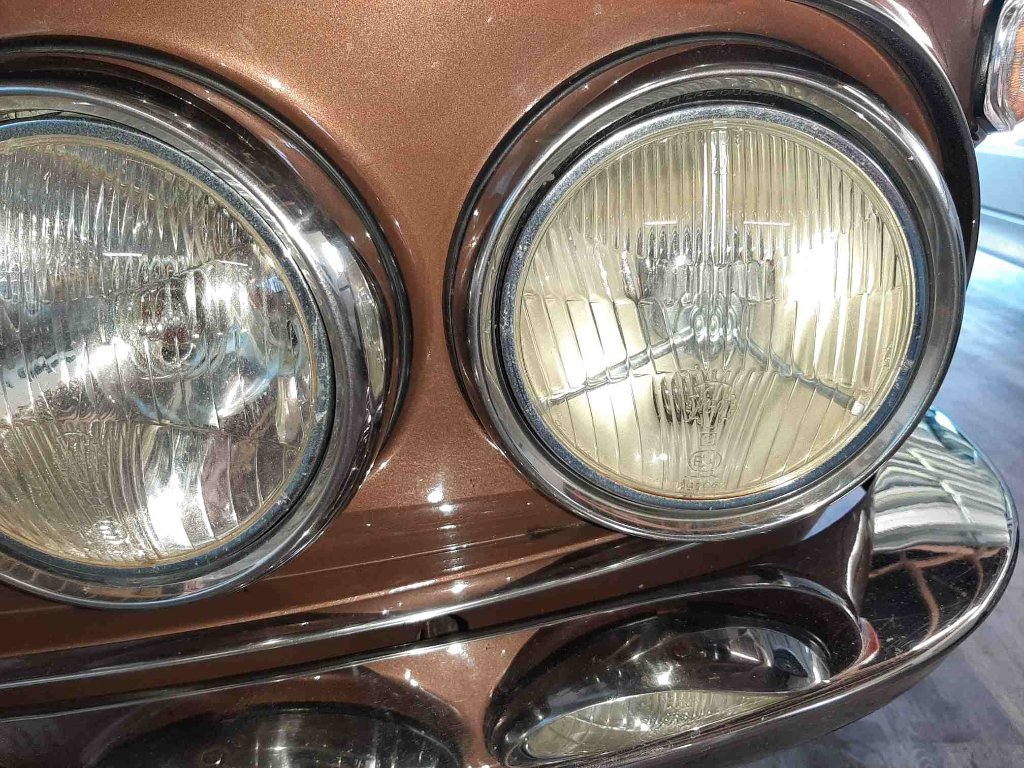

One of my outer headlights on my S1 coupe (RHD) turned a bit yellow so I am looking to replace it (or both sides) with another original Siem unit. There are a few new ones available on ebay etc in Europe but I am not sure if LHD and RHD units are the same (the light only, not the "cup"). I can see in the parts book the American cars were different but it is not that clear on the rest and whether it refers to the light or cup. Does anyone have info/ experience with this?
