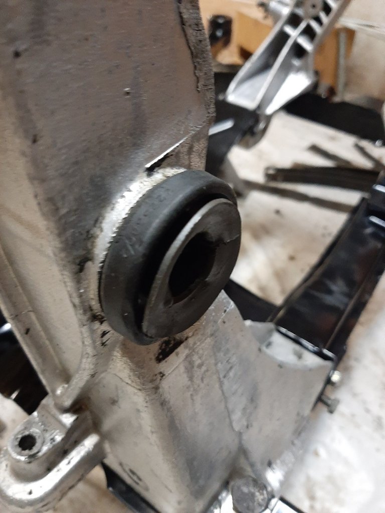

Hello,
I believe I made a mistake when I took apart the silent blocks of the upper arms of my S1. The silen block seems to be made of 3 parts. The rubber grommet that sits into the cast alloy tower, an inner plastic sleeve (like nylon with a shape very similar to a motorbike handle) and a metallic insert with a similar shape that goes between the bolt and the nylon piece.
The system seems to be beatifully engineered since the arm rotates around a lubricated metal bushing, but vibration are smoothed by the rubber grommet. In addition play is eliminated adding shims on either side of the cast alloy tower. While I was taking everything apart I thought that the plastic sleeve was supplied with the rubber grommet, and since they were very badly stuck in I destroyed them. Do You guys know where I can source them? Or maybe should I have them made in some oil resistant plastic?
many thanks
luca

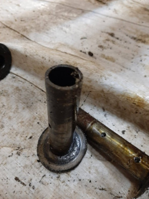

I think I will need to do the same. Do also the lower arms have the same system? I did not find the metal sleve inside, now I'm worried I threw it away!
I wonder if I can get them 3d printed, probably easier to groove them and I could use Nylon?

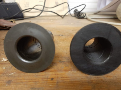

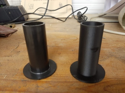

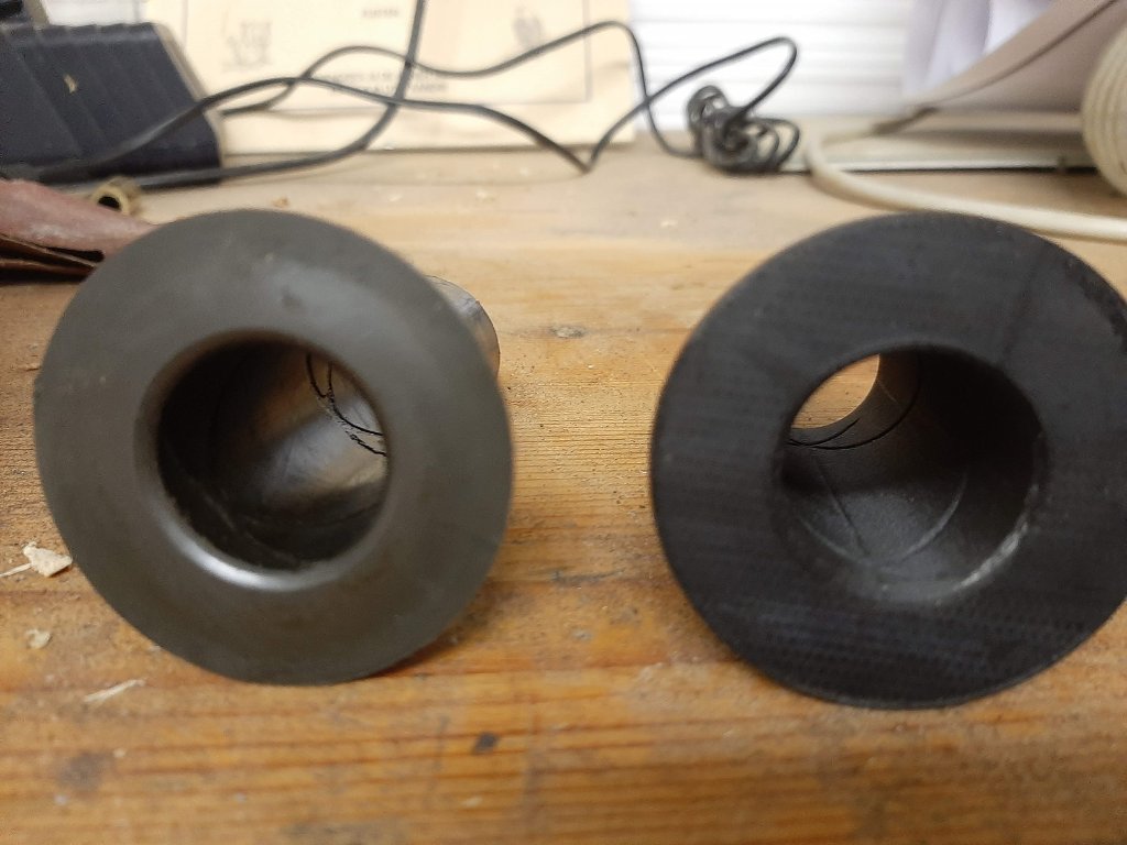

I have created my own bushings with 3d printing!
The internals are identical to the original ones (left in the picture) and the material is oil resistant plastic, filled with carbon fiber, and reinforced with a fiberglass wire laid down during 3d printing.
If You're interested let me know and I can make more batches. I'm using a professional printing service with the correct printers as this is not a cheap printer!
regards
luca
Huib
Site Admin
Posts: 1884
Joined: 17 Dec 2008, 10:12
Re: S1 upper arms silent block
Unread post by Huib »
Brilliant Luca. Good job!
The original is indeed much nicer than the later silent blocs.
There is a subtle difference in driving too.
