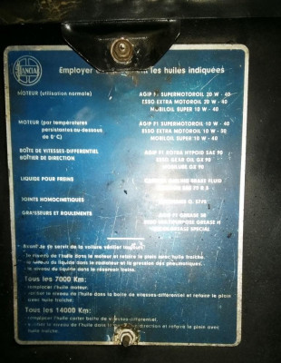

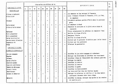

frequent servicing is shown on a plate inside the front boot; many other instructions in the CD and other documents; good idea to give new oil for engine and gearbox, bleed the brake system , chexk the direction and suspension

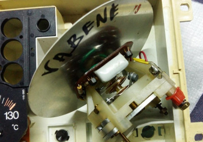

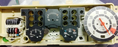

about the rev counter, I have a spare, which I think comes from a serie 2 Fulvia dashboard (cannot be used on mine, I bought this by mistake years ago...)
Se pictures, to check if it looks like yours;
