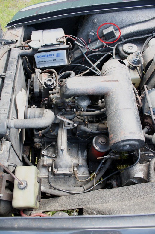

I recently bought a 67 Flavia Milleotto Berlina, and I have found some issues that need bit attention. The former owner have replaced the original generator with a modern style generator. I assume the old generator was a DC unit with an external voltage regulator, but the new one have an internal regulator. My problem is that reading from the ampermeter the battery doesn't get charged. I read a few A (ca. -5 to +5, depending on the revs) when the engine is running without any electrical devices switched on, but sometimes I see/hear the generator kicking in, giving 35+A.

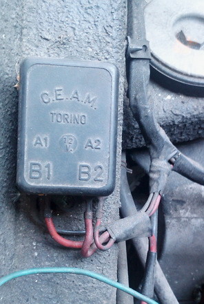

I am no expert when it comes to car electrics of this age, but my thoughts are that the generator has been changed without removing the old voltage regulator. Could this be a logical explanation for my problem? If so, is the voltage regulator the unit I have circled on the first picture? The second picture is a close up of the unit. Should I remove this unit, and join the two biggest red wires?

Re: Flavia Milleotto voltage regulator
From what I can see the alternator and its associated control box are standard and the same as on my Flavia 2000 coupe.
The alternator is equipped with internal diodes which convert the AC voltage generated by the alternator into DC. The black regulator box adjusts the current. I would not recommend joining the two red wires!
There may be an intermittent contact somewhere which could account for the current suddenly increasing. Have you checked all your connections and earthing points? (Note also, do not run engine with battery disconnected; this will damage the alternator which must have a load connected to it all the time).. The 35A figure you mention sounds about right when first charging and then should taper off to around 5A.
The alternator/regulator set -up is a standard arrangement and a good auto electrician should be able to sort it out quite readily.
A correction!
A friend has pointed out to me that the picture shows a relay. It is not the voltage regulator.
Apologies if I have led anyone up the garden path.

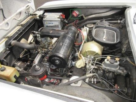

Hi,
Attached a picture of my Flavia (S2 Milleotto 1968). The SEV regulator is the part surounded in green.
Just during few minutes after starting the engine, the amperemeter shows "30" amp. Then the value decrease quickly to near "0" Amp.
I use this car since 2014 with this configuration, without any issues.
If I remember weil, the relay is for the electric fan motor.
Pierre
Pierre,
From what you say, the alternator (Not generator, they were on earlier Flavias) is working correctly.
The ammeter is indicating a quick boost to the battery after starting and then it settles down to a low charging rate as you describe. Probably if you went on a long drive, the charge rate would get even lower as the battery voltage rose as it became fully charged.
Yes, the black relay is for the electric fan. You should check that it is working correctly. Bridging the terminals on the thermal switch on the bottom of the radiator, with the ignition on, should make the fan run.
On my Flavia 2000 coupe, I have fitted a switch which allows me to turn the fan on rather than wait for the engine to get up towards 90C before coming on automatically.
Regards.
