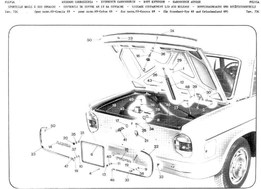

Hi Thomas
I am not sure to understand what is your problem
I found "old" pictures in my computer, before replacing the lock in place some years ago
Does it help ? There is a small scew that locks the cilinder so that it cannot move out (you can see it separated from other parts on last picture
Also a page from the technical data
