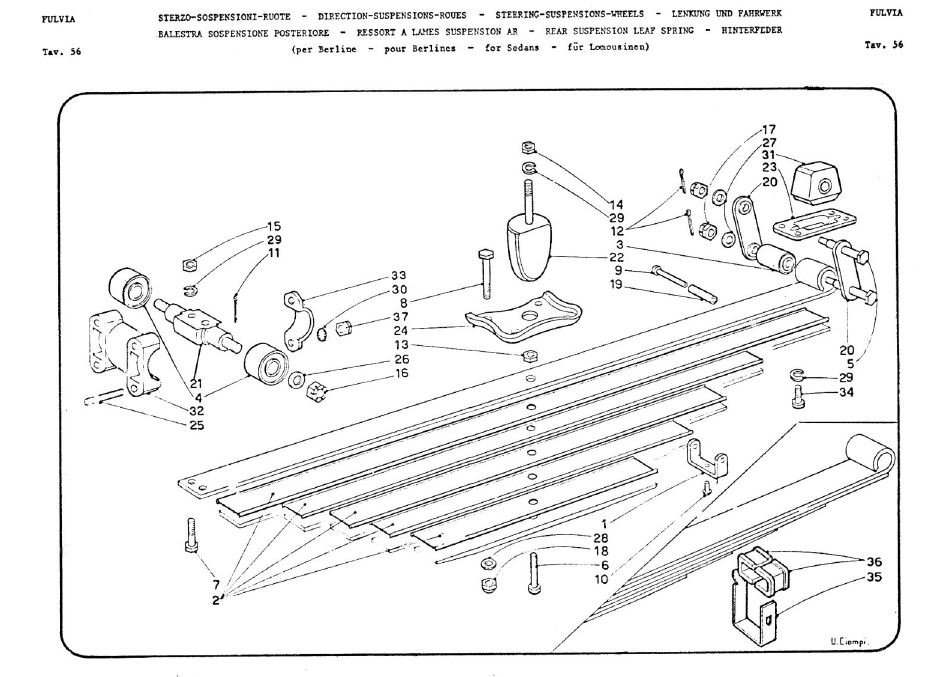

To day all parts with new rubbers are in place; and the distance between spring and bumper is close to 8 cm (with load in the boot)
I am just trying to be sure about torques values for different bolts with the data on DT 07/0010
does the 4 bolts 5 & 17 correspond to n° 9 of data 07/0010 ? (torque 4.0 mkg)
idem Bolt 16 correspond to n° 10 ? (torque 2.8 mkg)
All others seems clear.
Best regards
